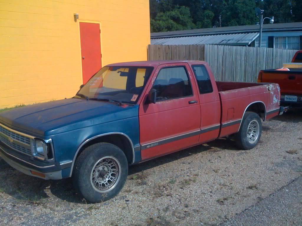

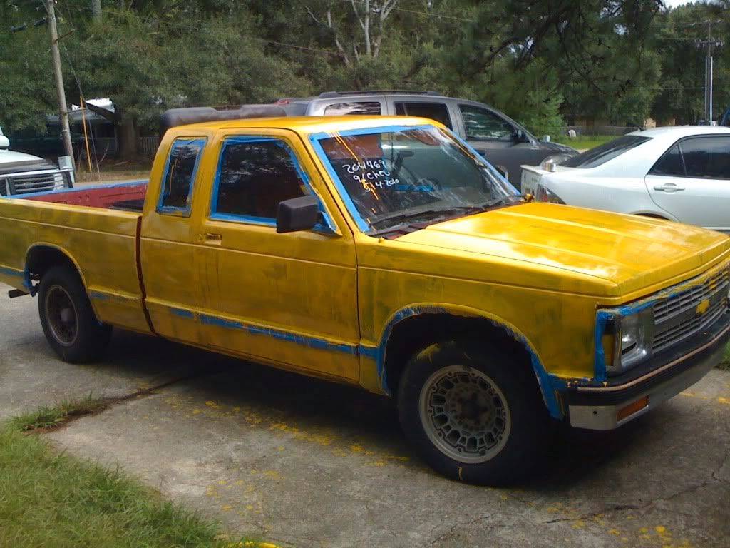

Well, here we go. I didn't go around advertising it much, but I got sick of tearing up the Lexus trying to get it loud so I bought an S10. I was looking for a CRX (duh), but wanted to be different (or so I thought) and I found a good deal on an S10 locallay so that's what I went with.
Big ups to all the Team Redstick guys who put in just as much work as I did and to Alan Hall for all of the advice. Nobody does all of this **** by themsleves. This truck was truly a team effort.
As I bought it.

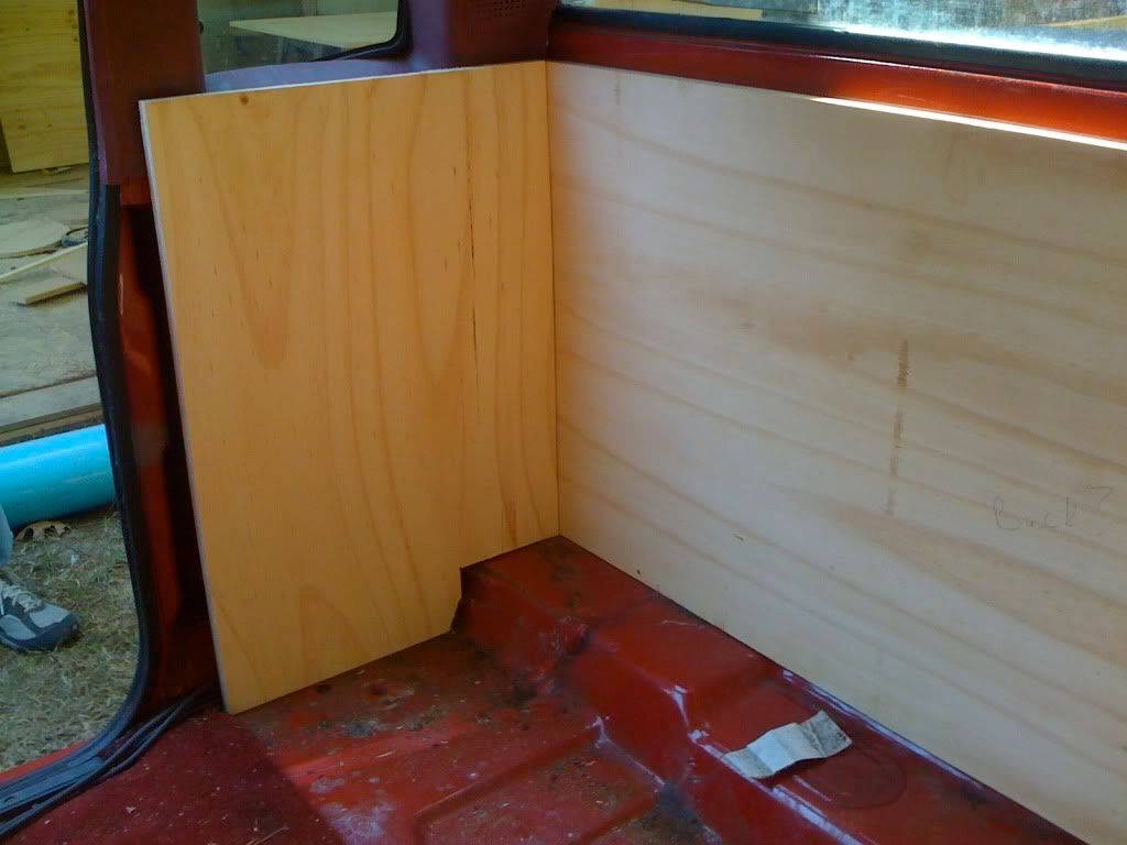

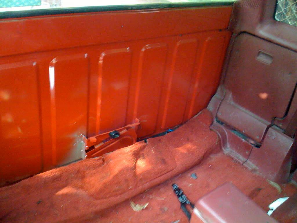

Guttting. Those jumper seats actually came out (which is legal).

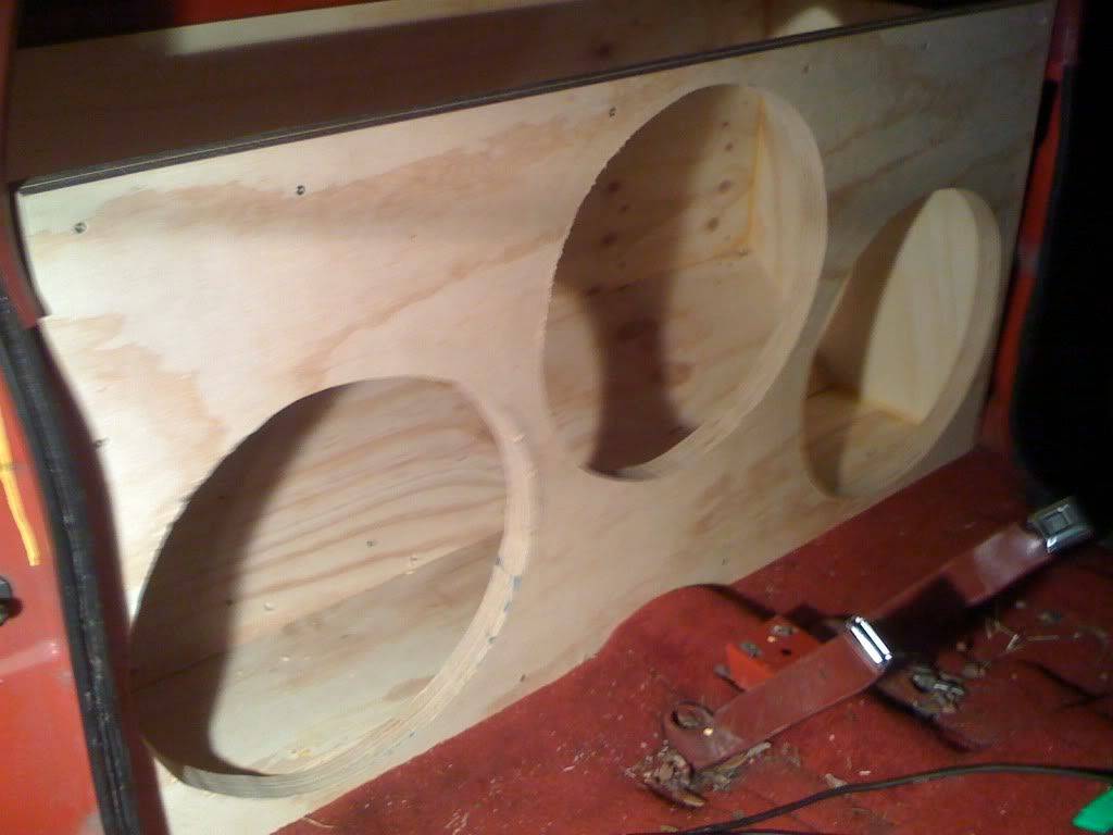

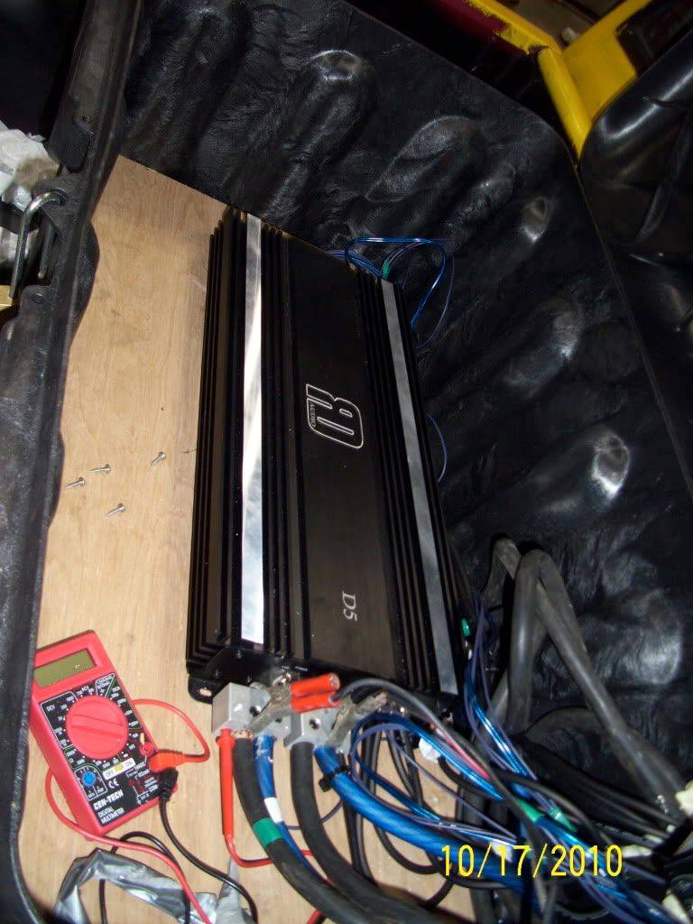

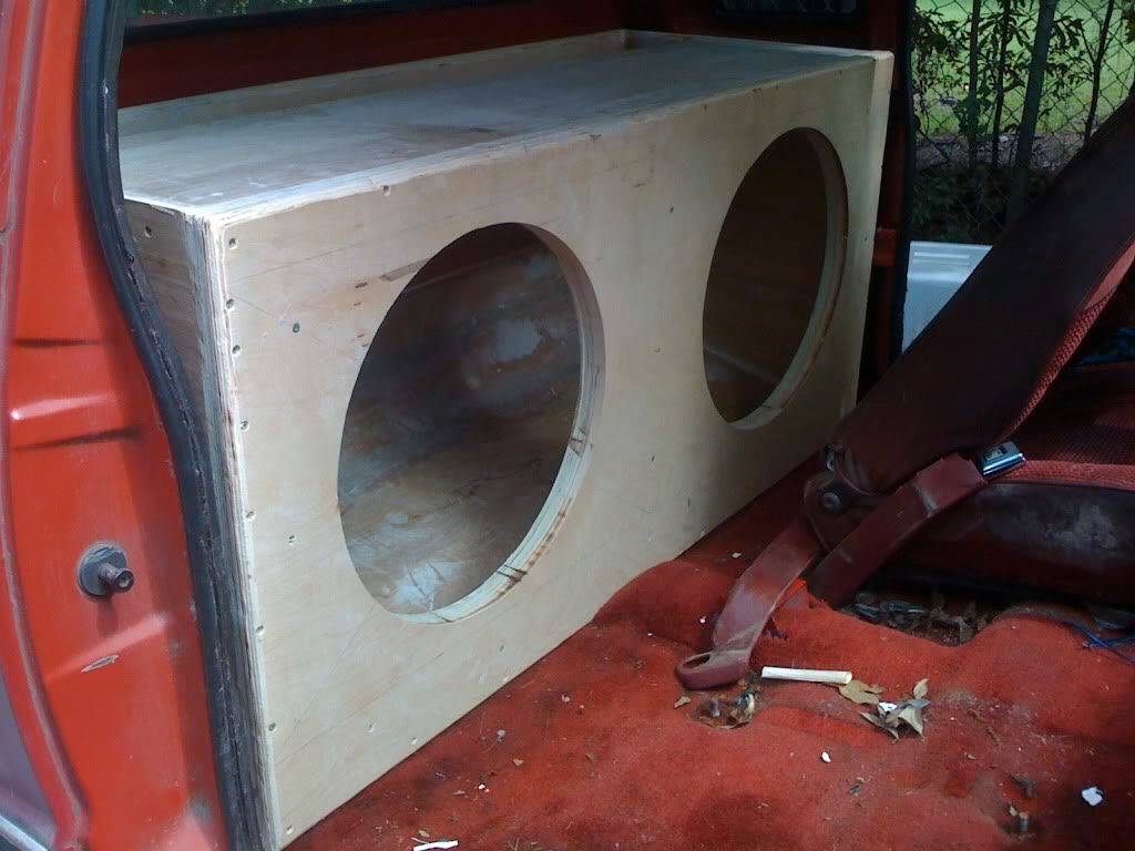

This was the first box. The one that I used at SikNic and to accumulate all of my points to make it to finals. This box did 156.3 with 2 AQ 18's on a D5 and actually set the records in my sig.

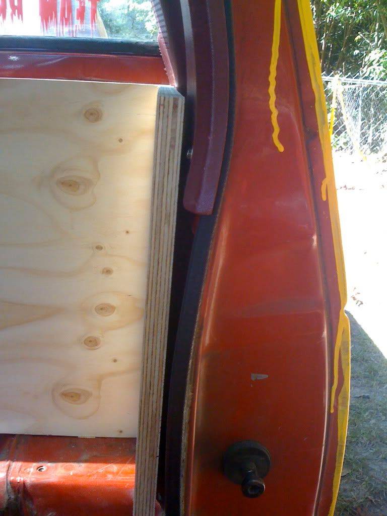

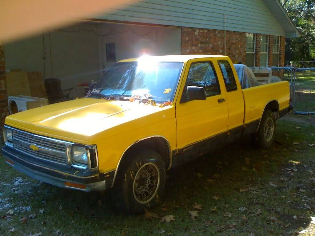

Don't remember who's bright idea it was to try the $50 paint job, but here is the first coat. Notice all of the yellow on the driveway. We all had yellow on us for weeks. F3M4's girlfriend actually still has some on her toe. Lol. It cam out umm... ok? As long as you stay more than 25ft away from it. Lol.
3 coats (and no sanding later).

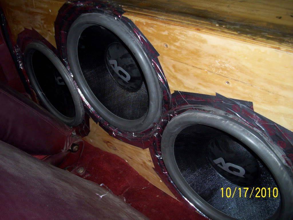

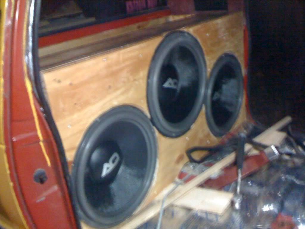

Anyway... wanted to squeeze every db we could out of it so I decided to add another 18 along with about 100 sq ft of deadener, filling in the voids on the sides of the box and every other trick any of us could think of. So a new box went into the works.

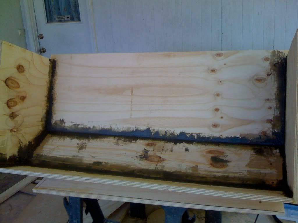

Kitty hair in all of the joints.

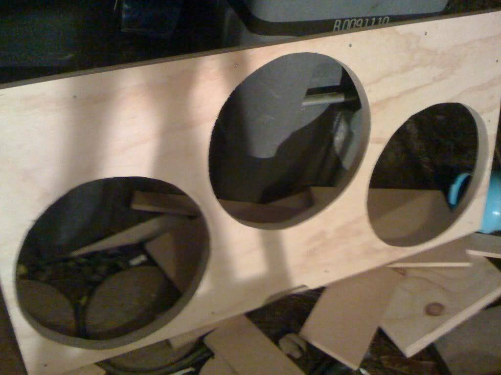

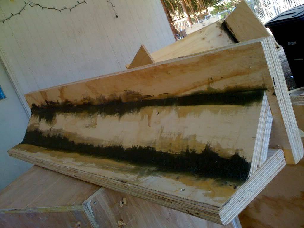

Port and top.

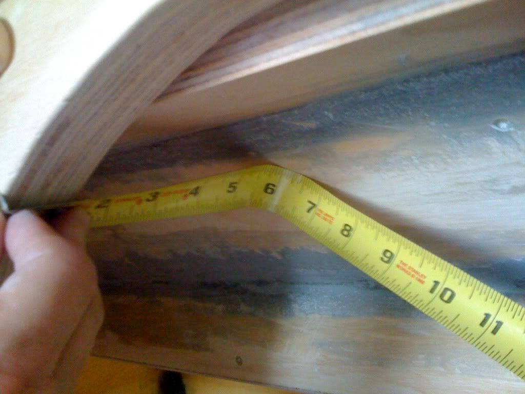

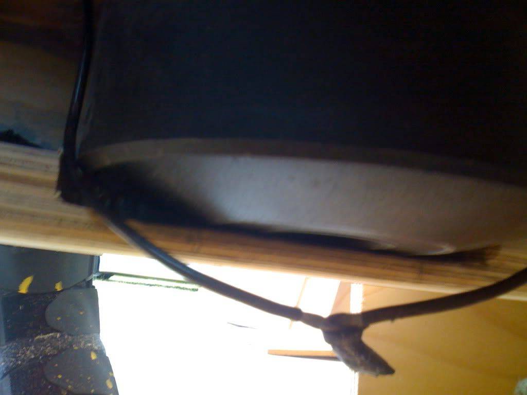

As you can see, the middle sub being higher than the others didn't leave enough depth to fit.

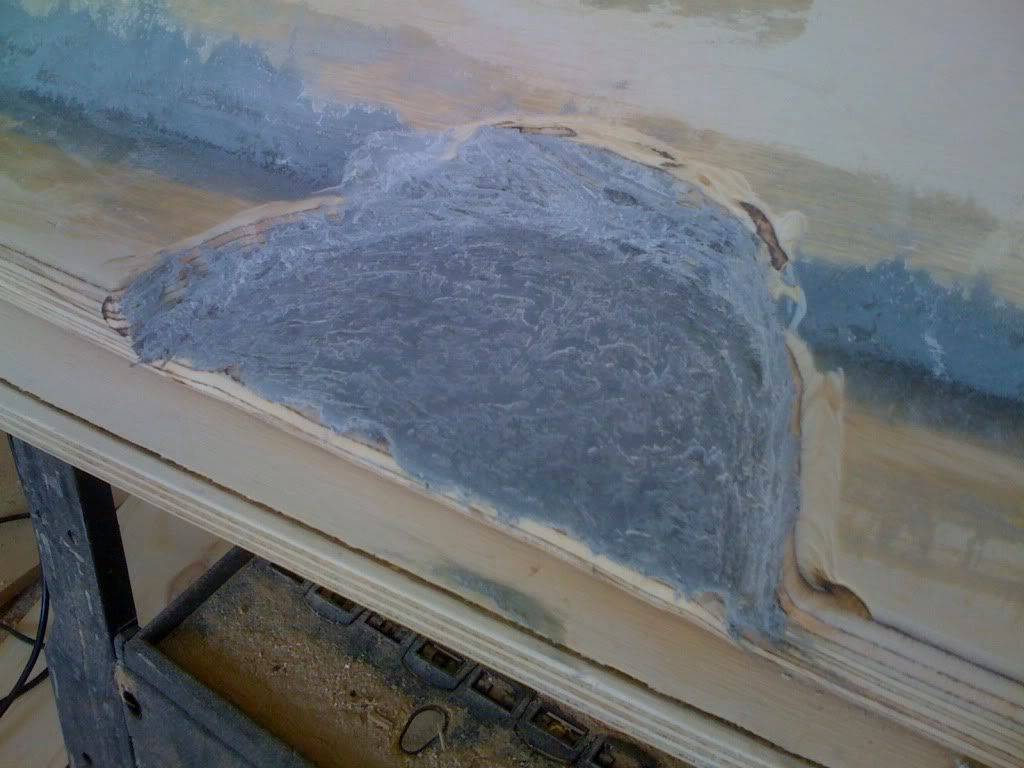

Had to notch the port and 45*. Filled with kitty hair, sanded and resined everything.
Still not much clearance, but hey, it fits.
Finally got all of the deadener layed and box in the truck about midnight on Wedneday when we were leaving for finals on Fiday morning.
The finished product. We did all of the taping and finishing touches (hungover) Saturday morning at finals.

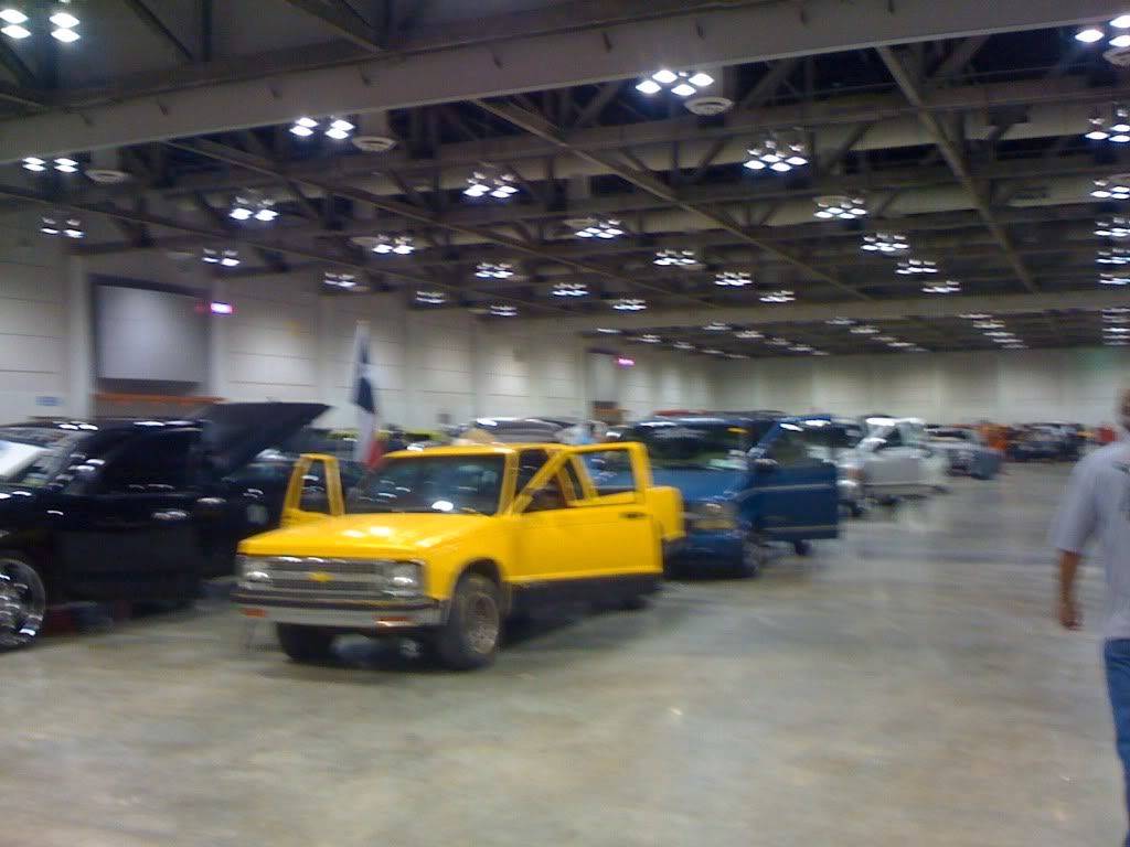

Here's the turd at finals sticking out like a **** on a fish. The ugliest vehicle there. I had the front row outside corner. Awesome. Lol.
