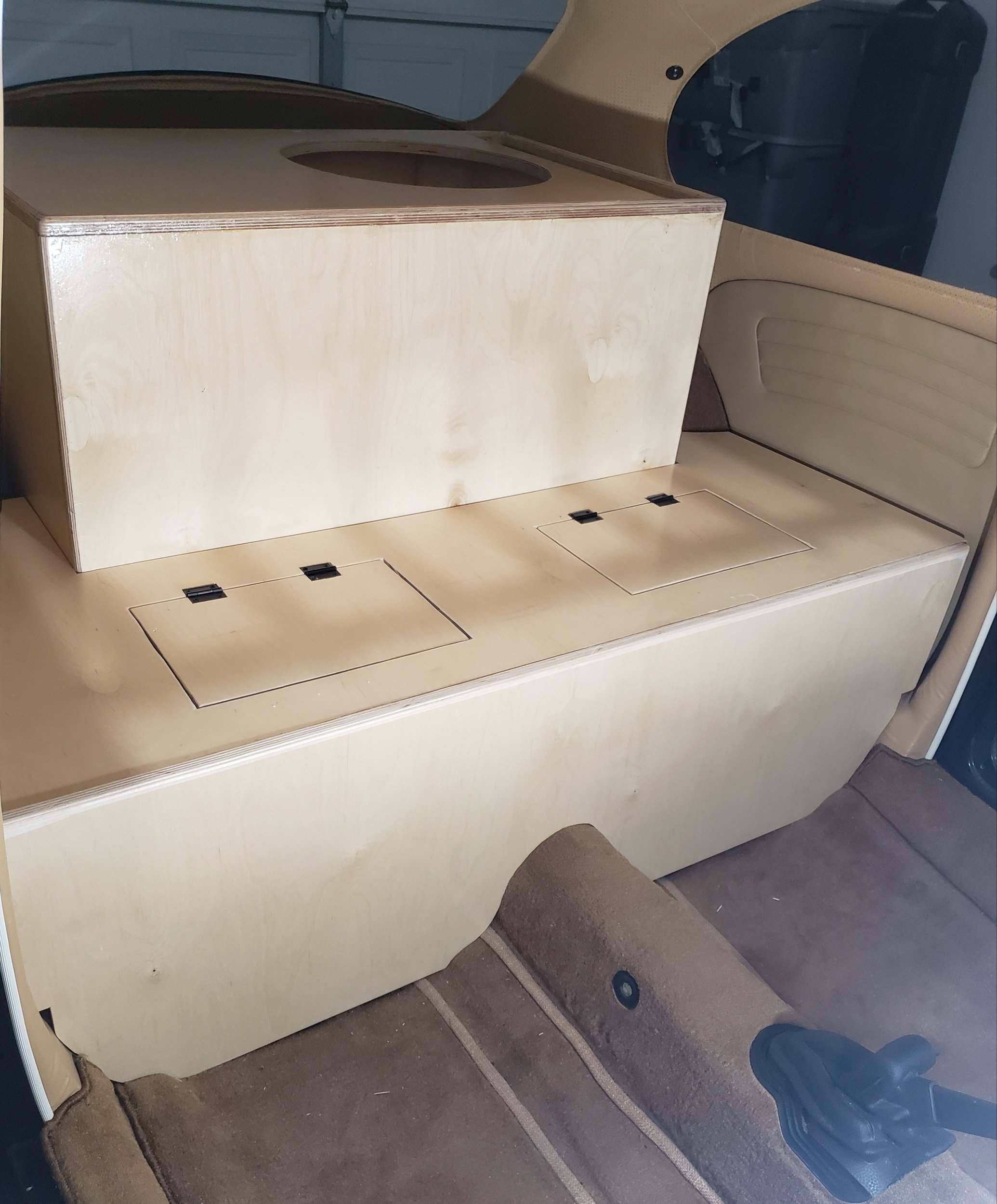

Does anybody on here have any experience with them? I bailed on a DSP (long story), so, I am getting a Taramps CRX4 4 way installed next Wednesday to finish my build up. I'm running the following;
Headunit- Kenwood DDX771
Taramps CRX4 4 way crossover
Speakers-
2- Pioneer TS-B350 Pro tweets
2- Pioneer TS-M650 Pro 6.5" midrange
2- American Bass VFL65MB 6.5" midbass
1- American Bass HD15D2 (3.9 cubes ported net tuned to 32hz.) 13 ply Baltic Birch clear coated
Amps-
Taramps DS250X2- tweets (8 gauge)
Taramps DS800X4- midrange and midbass (8 gauge)
Taramps MD3K- sub (4 gauge)(Only and 18" run to the battery)
Two AGM batteries
Small Alternator (biggest that I could find for my car)
LED voltmeter in the dash (wired directly to a battery)
Big three 1/0 Sky High OFC
14 gauge OFC for speakers
8 gauge OFC for Sub
Knuconcepts RCA's
Orion Stinger 8000 RCA for Sub
Whole car is sound deadened (doors, rear quarters, roof, sunroof, under the dash, and under the front fiberglass hood) Even the roof slats on the luggage rack are padded to prevent any rattling.
Any thoughts? Did I screw up anywhere? I did all of this unemployed. Including purchasing and finishing my car. Sorry, if it's in the wrong section. 😂
