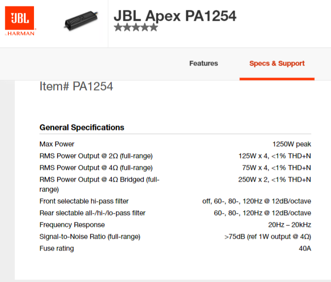

Can you post pictures of the part of the amp with the gain and crossover controls on it? What head unit are you using?
