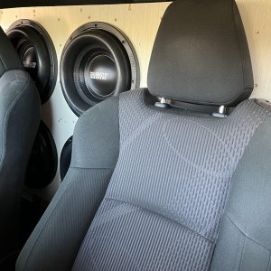

Doing an enclosure build this week for a guys suv for 4 SSA F8L 8s. He requested that it be 1.5 inches thick all the way around and It’s getting a double baffle with an extra 3/4 inch flush mount beauty panel, so technically a triple baffle. He also wanted MDF, but I wanted to use wood with real fibers for the kerf. I have a little bracing to add in still before I close up the top. Sending update pics to the customer and thought I’d post here and give my back a few minutes rest.

You made that kerf look easy
Anyone whos has attempted one knows its far from easy
Yours is perfect though
Last one I did I messed up twice before I was happy with it
That woods not cheap to be screwing it up
Well done
