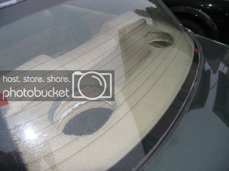

This works great for newer GTOs. With the gas tank, rear firewall, thick leather rear seating all in the way, leaving these open makes a huge improvement on output. However a new problem arises. Fuel Pump whine. It comes through these hole clear as day. So what I did was put a layer of egg crate foam over the holes. It attenuates the high pitch whine while allowing plenty of bass to go through.
