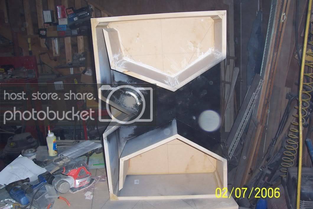

The chart above shows the SPL response potential for a pair of 10" Rockford Fosgate woofers (RF108's) in a perfect 4th order enclosure of 10.01 cubic feet. The response is indicated by the blue line in the chart.
Using the same woofers, the response was measured after installation into this dual band pass horn. The results of that are indicated by the red line in the chart.
The yellow area represents a serious gain in efficiency between the two enclosures. The dual band pass enclosure is also smaller in size by 1 cubic foot.

How's this:

It's not that big really . a pair of 8's in this one in the back of the chitbox
