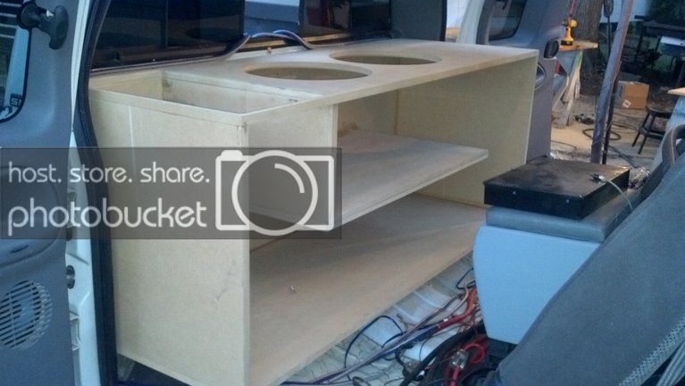

The second thread isn't a build log but I will make one when the project is finished. However, here is a progress pic of that line:
