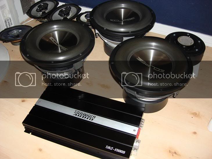

im stuck between a rock and a hard place right now. to my disposal i have 3 12" eclipse ti's and 2 sundown saz1500d's. my car is a 2002 honda accord coupe, decent sized trunk. within the next two weeks im going to have a ported box made but i dont know which would perform better with the space im given:
2 eclipse ti's w/ 1 sundown saz1500d @ 1 ohm
or
3 eclipse ti's w/ 2 sundown saz1500 strapped @~2.6 ohms
the only thing im worried about is how the 3 subs with react stuffed into a trunk, would i be better off sticking to just the two?
TIA,
chris
Yea 2 in the proper enclosure, this is my Caddy with 2 12" Eclipse TIs off a single sundown 1500, like a year ago. Box was 3.3 @ 33hz I believe.. and remember this car is alot harder to get loud than your Accord //content.invisioncic.com/y282845/emoticons/wink.gif.608e3ea05f1a9f98611af0861652f8fb.gif
2 with the proper enclosure. I bought two sw9122s used and the box was a little small for them, I had a 3db gain when i built a bigger box (still daily driving set up). plus you should have no problem seeing your 3rd, or keep it as a spare. pics and vids when youre done!
thanks for the quick response guys, two it is. i just wish these subs would be able to handle the two amps strapped, bummer
btw: from your experience what box would work out best?
i was thinking somehwere between 3.3-3.5 c/ft @ 32-34hz? im basically looking for a good daily sql setup

You don't need that much, just run one at 1 1500 @ 1.
yeah thats probably what i will be doing. i just hope there will be a noticeable difference from my pair of eclipse aluminums im running right now (prefab sealed 1.25c/ft each. )
im setting up an order with fishercustoms so we'll see results in a week or two.
I cant wait to get these guys up!
