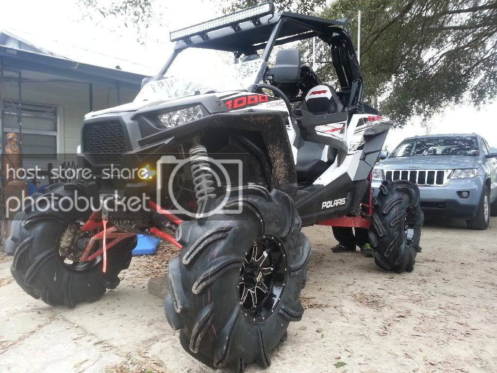

PIC of rzr for reference (can see the wake towers mounted on bar behind the seats.)

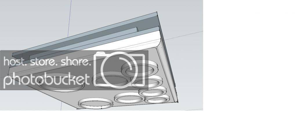

Design of box, roof will come off box will get built inside of cage, roof will go back on top. Should show about 1/2 the cage bars all the way around. Notice the roof is way wider than the cauge in the back, may extend the top of box in this part and do something for the 4s mentioned.

Seems like way to many different sizes and an odd arrangement to me, I would do 4 6.5" and the subs run a 5 channel and call it a day. Should be able to get plants loud(the speakers are like a foot from your head). I'd guess if you get to crazy your going to have to deal with cancellation issues. Just my 2 cents, kick *** ride by the way!
Yea, the reason i wanted the 8s was i figured they would carry the vocals and mids better and get way louder than the 6.5s. A lot of the time when im in it, most of it will be off, thats the reason i was thinking seperate amps on switches. On big rides though usualy it just turns into a big party at night, wheather its on a sand bar on the river, or the big pit at the mud park and when that happens I want it to get stupid loud cause I wont be sitting in it. Right now the 2 wake towers are running on this lil throw away amp http://www.amazon.com/Pyle-PLMRMP1A-2-Channel-Waterproof-Amplifier/dp/B003HH9FIQ/ref=sr_1_2?ie=UTF8&qid=1417963517&sr=8-2&keywords=PLMRMP2A which was a quick fix cause i wanted something waterprof with a volume knob. Its loud enough just that sitting in it. Its not worth turing on if your going to get out of it though. I was supprised it plays well when completely underwater lol.
And thanks I love my bike lol!
What kind of cancelation issues would I get? I was thinking running the subs LPF at 50 and the HPF on the 8s at 40ish. The 6.5s and towers at maybe 60ish. Like I said at this point I was thinking make it loud lol, but maybe im going at it the wrong way.
