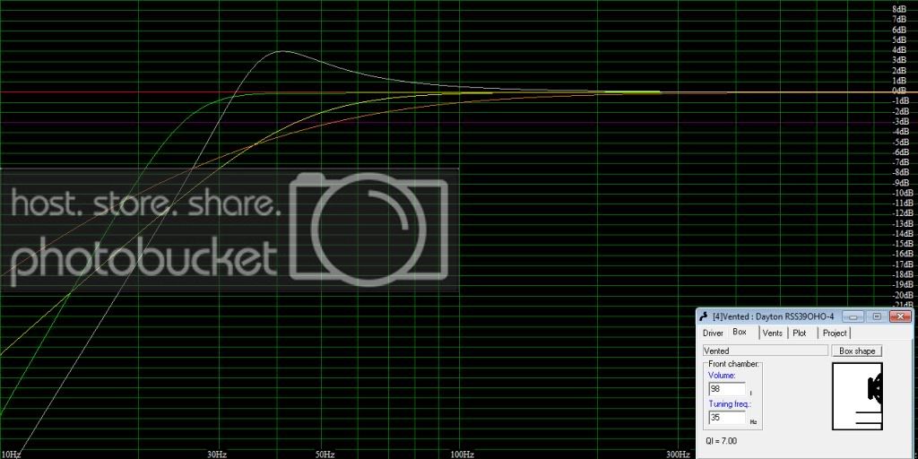

Ill never understand why people claim that their ported boxes will play "lower".
This is why. The yellow line is WinISD's optimum sealed specs, while the orange is modified to give the loudest response possible at 20hz for a sealed box.
The green line is WinISD's optimum ported box, notice how much low end extension it has on the sealed. HOWEVER, most people tune their ported boxes at around 30-35hz (the grey line is a ported box tuned to 35hz). They do this so that they can get that peak in output, this cuts their low end extension though.
Ported boxes can play much lower OR much louder than sealed boxes, but you can't have both.

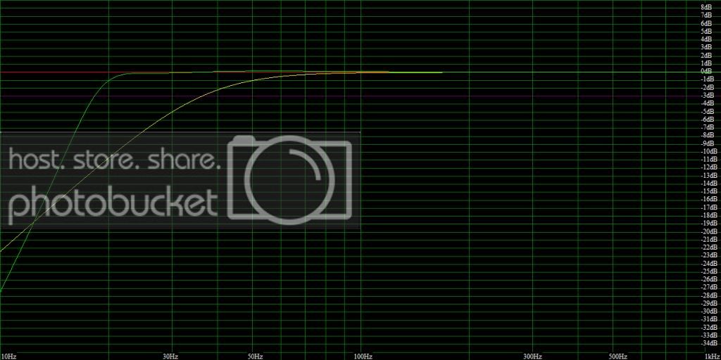

Here's your sonys in an optimum sealed (yellow) and optimum ported (green) box:
^THank you very helpful.
