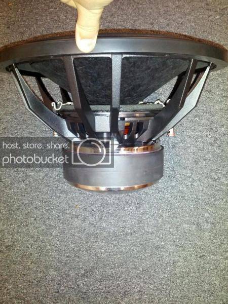

What so special about this woofer?
Why is there so much mechanical noise on this video? Woofer sounds horrible
nothing special 3" coil, shorting ring in the magnet ID 18mm topplate standard 8" medium stiffness progressive spiders. there is no mechanical noise until about 32 mm where its the KMS based distortion. thats at 19 with 1500 on it.. it held up very nicely.. thats well beyond its rated 26mm xmax thats appraching 35 mm
