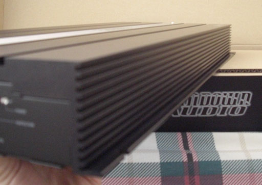

Our amps run pretty cool - the heat-sink is very thick on them //content.invisioncic.com/y282845/emoticons/smile.gif.1ebc41e1811405b213edfc4622c41e27.gif We do not use fans.
thick alu isnt the best way of getting rid of heat. tall thin fins on the sink to give more surface area is best. class D's dont get that hot normally...

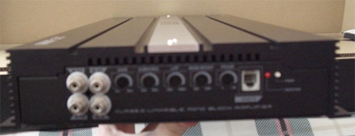

The new case works out quite nicely - we didn't just make it thicker - there are 10mm tall fins under the face of the amp and some extra fins on the sides.
The original case really never had any thermal issues to begin with, though - I primarily wanted the new case for future, larger, Class A/B amps. I also did not want to completely change the look of our amps //content.invisioncic.com/y282845/emoticons/smile.gif.1ebc41e1811405b213edfc4622c41e27.gif If we do another complete revision I may try to work in some bigger external fins - but I am pretty happy with the performance we get out of the casing now.
* New Case on the sides
* New Case internal fins
* Older case had no internal fins and had fewer fins on the sides - the thick aluminum segment under the FETs was also 10mm thinner
