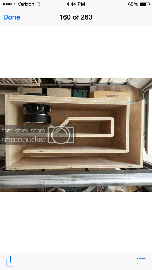

Heres an sa-8 tline actually and it might be the one CSCStang has for sale.
T-lines are big boxes
Wow that's ****... Now would the output be louder then a 10 or 12 in a l port box.. I guess I'm trying to cover a lot of thing here. 1. Built my 1st t-line. 2. Get a wow factor from a small sub
hmm... so thats what that is. ive seen a lot of people with home systems using t line enclosures and wondered what they were called. **** those things are massive... do you sacrifice bandwidth for output with these?
Yeah thats the one for sale. It's for an SA8v2 d2. the d4 has a different fs so the port would be slightly longer. That box in the pic is 32.5x16.75x12. Perspective: I did one for my hds210 inverted (to save room) and it is 24.75x25x12. I also recently did one for an hx300.5 12" and it's 36x21.5x14.5. They can be very large boxes. I have a design for an hds208 that's 27x12x12 with the sub inverted as well. You don't need to feed them a grip of power to get a ton of output. The hds208 is getting 300 rms @ 2ohm and it gets very loud.
Would it be louder louder then a 10-12 with the same power in a L port box? I like the look of the 8 inverted In a t-line
The whole purpose of a t is to get loud on little power. My one hds210 was 25-30% louder than when I had both in a ported. On the ported box I was giving both subs 1200rms@1ohm. In the t I was giving the one 600rms@2ohm.
