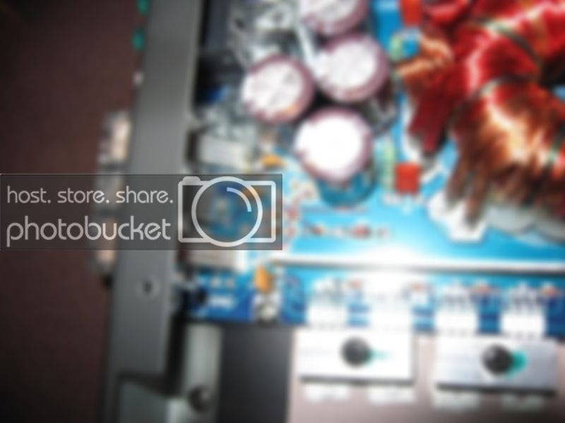

the rca connections looked fine to me. looking over everything else i noticed this...

let me know what i need to do to get this taken care of.
