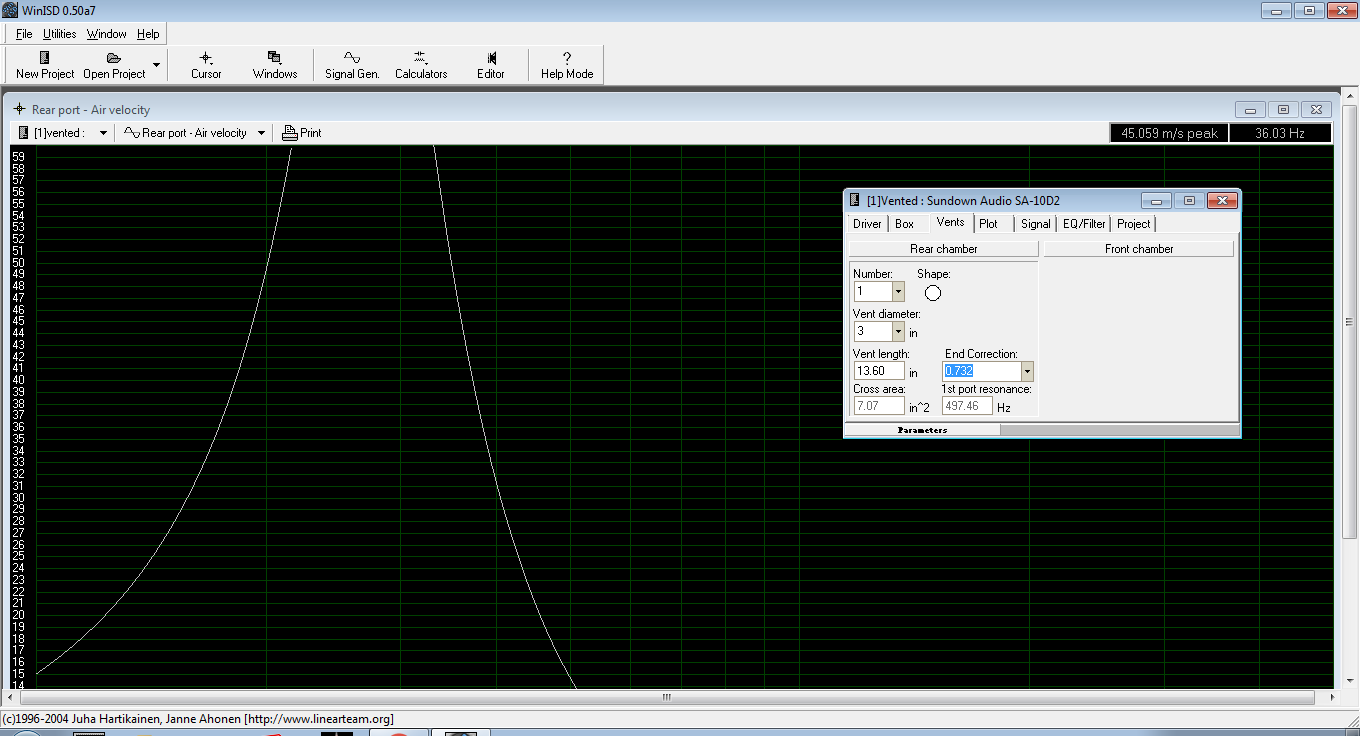

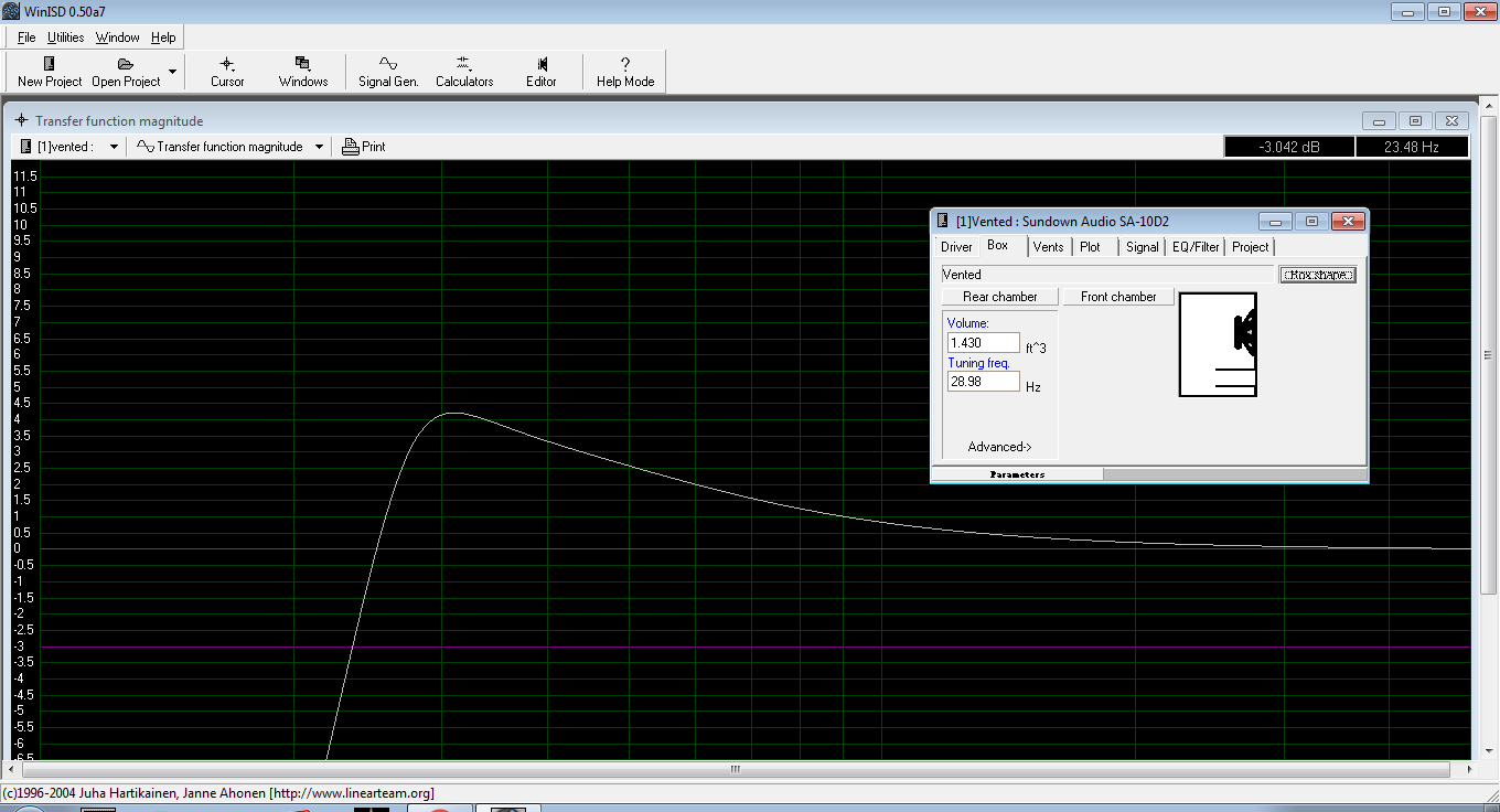

OP... what length and volume did you end up with?.. I just got home in front of the computer and the 3", 13.6"long port in a 1.43ft3 net looks like a 28.98hz tune...

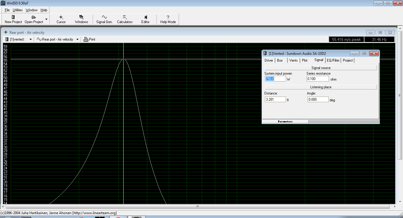

And for your power its a little high on port velocity for my liking... thats in m/s btw... lol

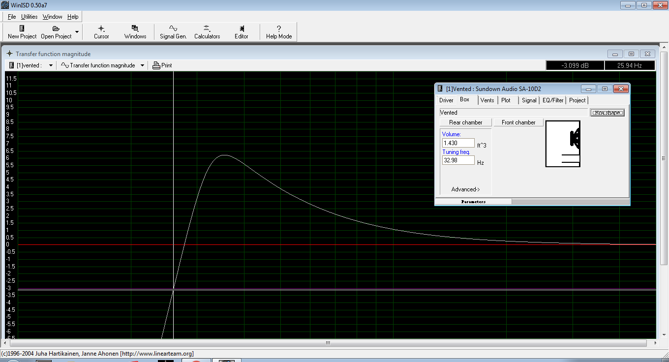

Now the same 1.43ft3 net with a 4" round 18.75" long will tune at 32.98hz...
This is a little better, I'd go with this anyday... flare the ends and youll be fine
That 3" port would be fine for a 700 watt amp IMHO
