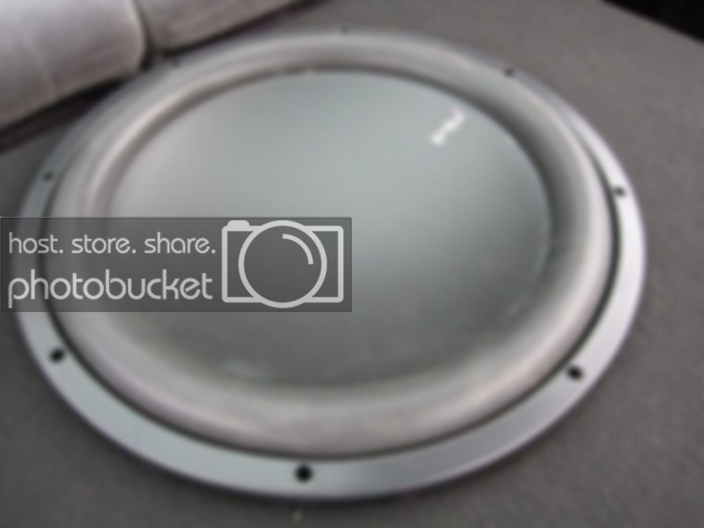

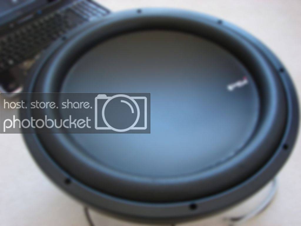

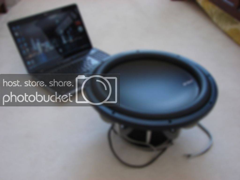

Got the sub today. I need to sand a couple of pieces of the box and then I will be ready to put it together.
Box ended up being 4 cubes to 32hz after all displacements. I should have completed pics by the end of the weekend.
Sub is very SEXY!!!!!

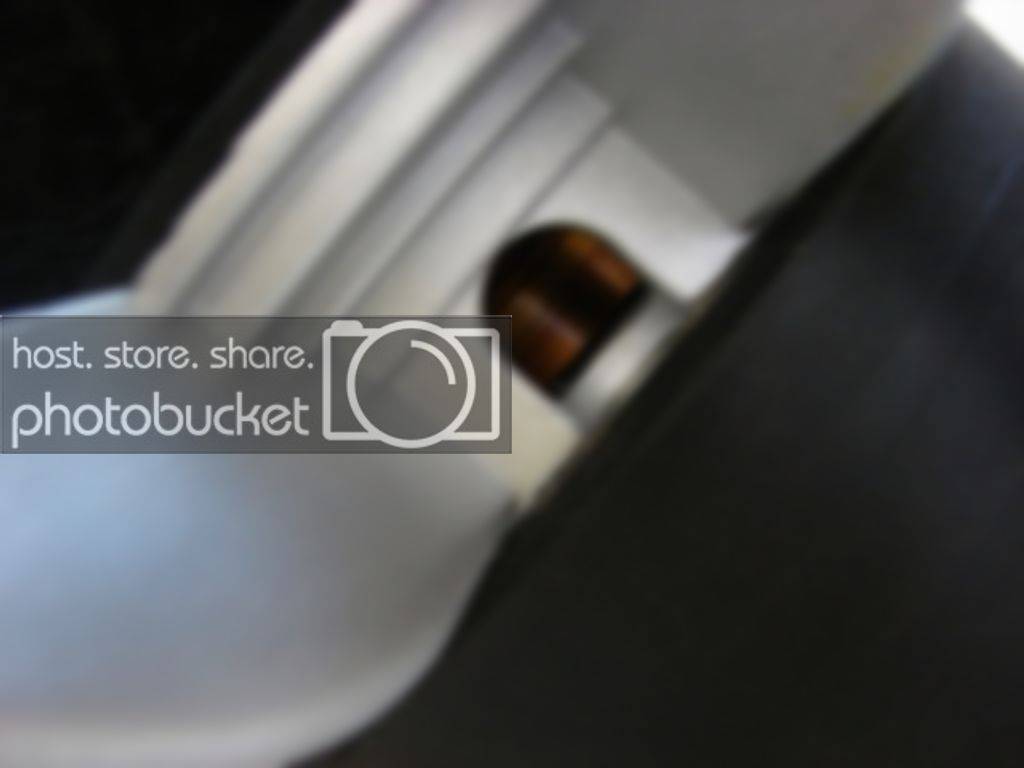

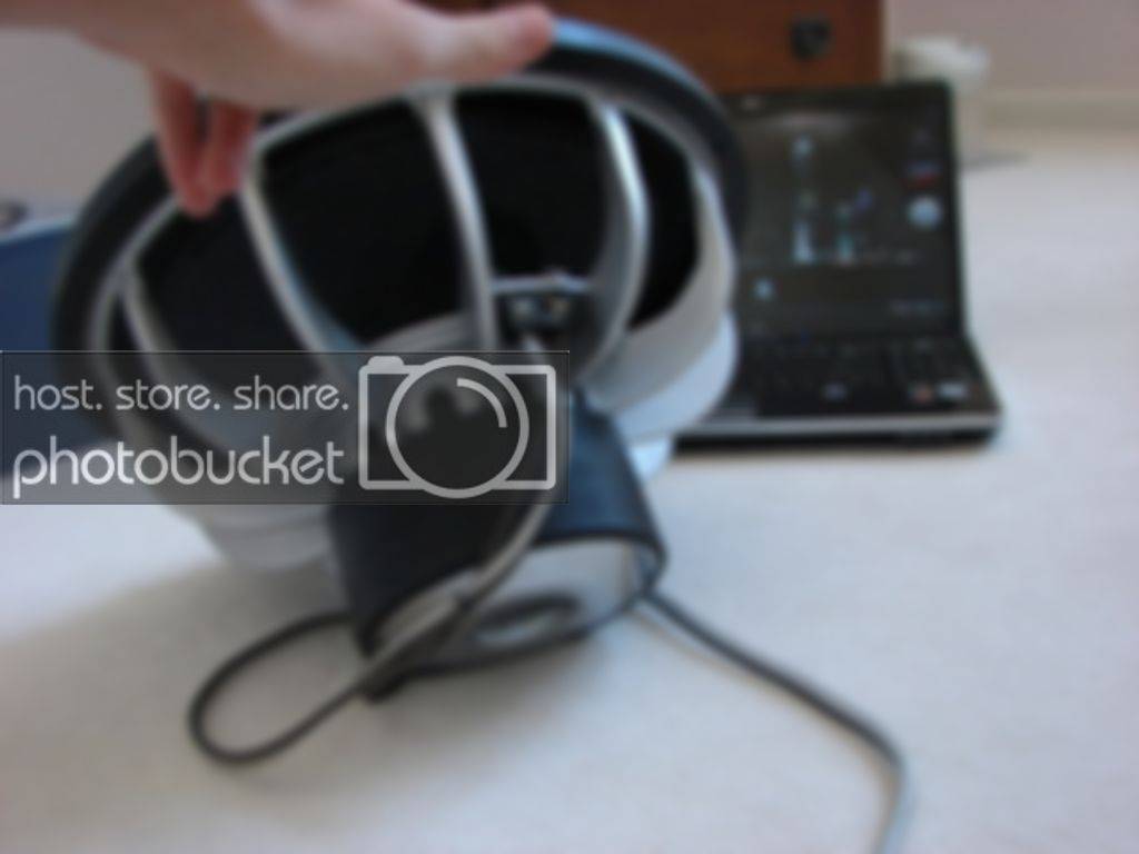

Check out the flat wind coil!!!
It took ten days for the sub to leave my hands and be dropped back off on my porch. TeamPSI has a great turn around time.

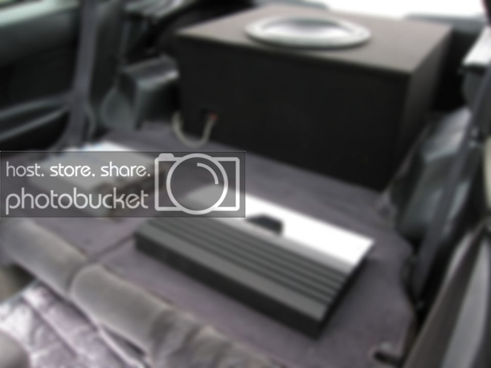

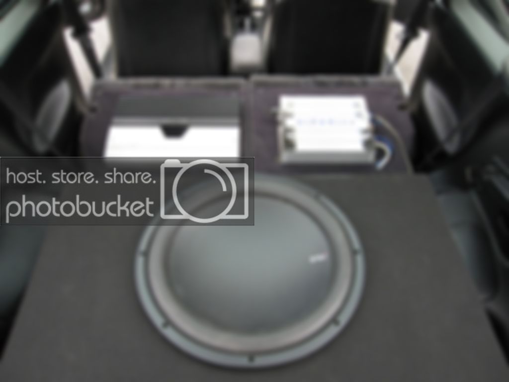

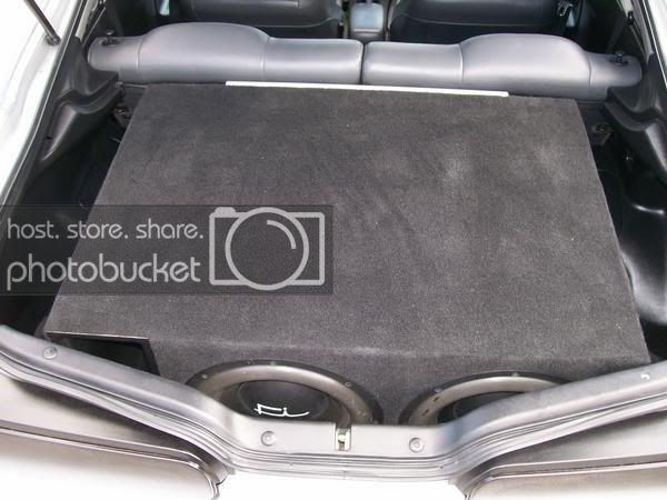

Got the box finished and carpeted today and installed everything after dinner. It is loud for sure but still needs to loosen up and some finish breaking in.
I have a vent in the next to the port in the trunk that lets air in and out of the car when the windows are up and I can tell it is killing my SPL. I need to rip it out and throw some mdf in there.
I will grab pics in the morning and will try to get my sister's HD cam for some legit vids.
I am loving it. Great output off low power.
Only thing is that there is no longer a trunk. You guys will see what I mean when I post the pics tomorrow.........
Box ended up being exactly four cubes to 31.8hz fully displaced and all braced up. It has 62^2in of port..............

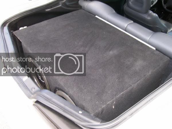

That looks like the same size as my box. 30x27x14.5.
I dont think mine will be that loud but who knows.
The sub is 1200rms and i got about 1200rms to give if I have a good electrical so all I feel like doing is upgrading my main batt and doing the 3.
It is really weird but my car doesnt flex anymore. I assume it is the sub up/port side configuration.........
