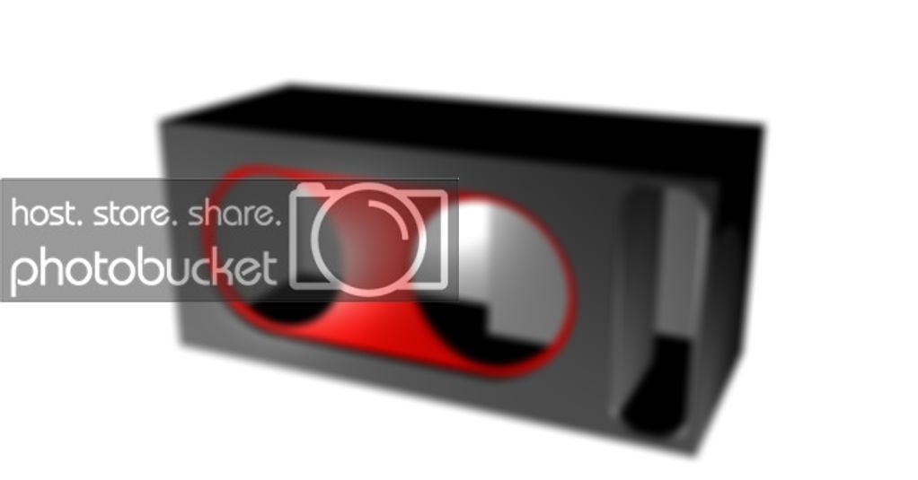

Here is the box design:
Instead of taking a large box/large port approach with this setup, i am going to go with a smaller box/smaller port and see how much power i can feed the R's. Hopefully i'll be able to find a meter to run on.
The clamshell box was tuned to 33hz, and i peaked at 29hz, so im curious to see how the outcome will be compared to a flat-faced box tuned to 32hz.

HMMM.... i LIKE THE DESIGN but if I had 4 15's I'd try and use all of em.... but thats me. i'd do a square box almost with subs firing up and have the port fire into the cab. but that may not be what your going for. or even have 2 firing forward and have to firing up... just other ideas.
I've done about 40 designs for the bed of this truck. The best options are a clamshell design like i had before, or a flat-faced box. All of he other designs run into conflict with the port/sub coming into contact with each other. If i reverse mount, i cant use my rear seats. If i push the box deeper into the bed to reverse mount, i run into space issues. The list goes on //content.invisioncic.com/y282845/emoticons/wink.gif.608e3ea05f1a9f98611af0861652f8fb.gif

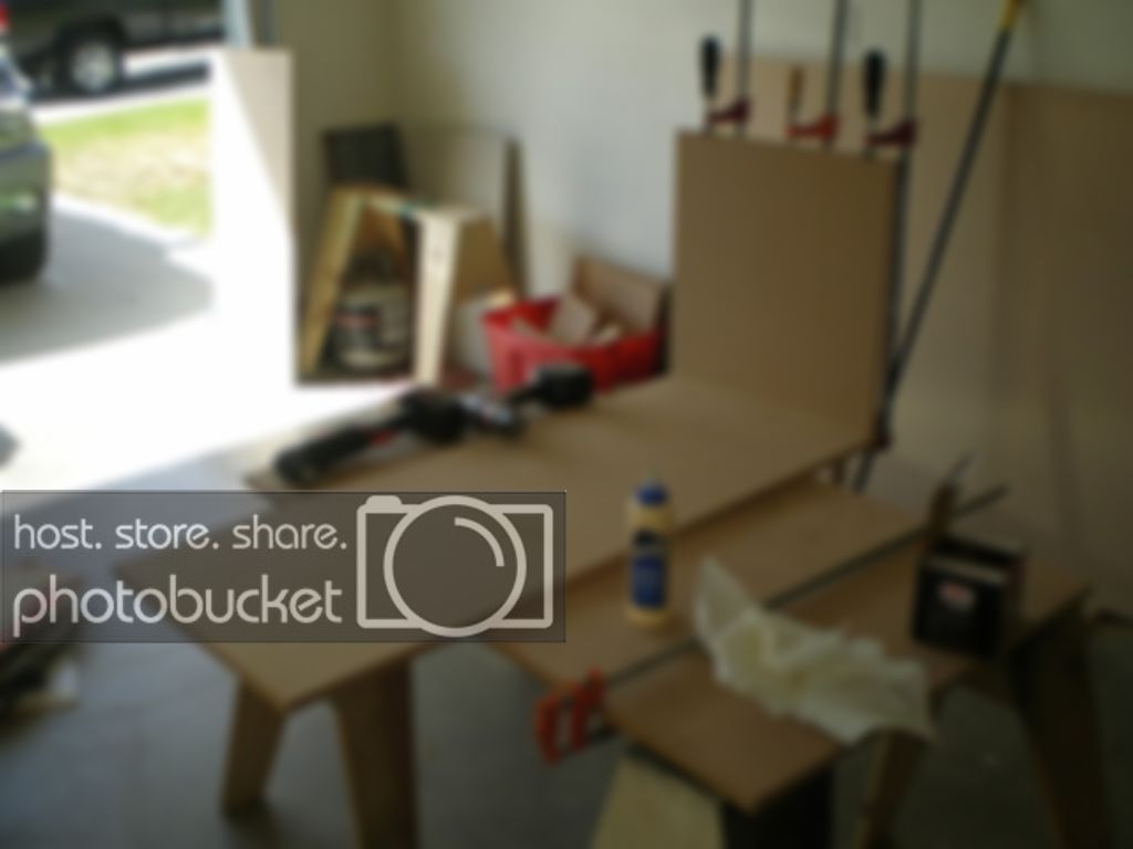

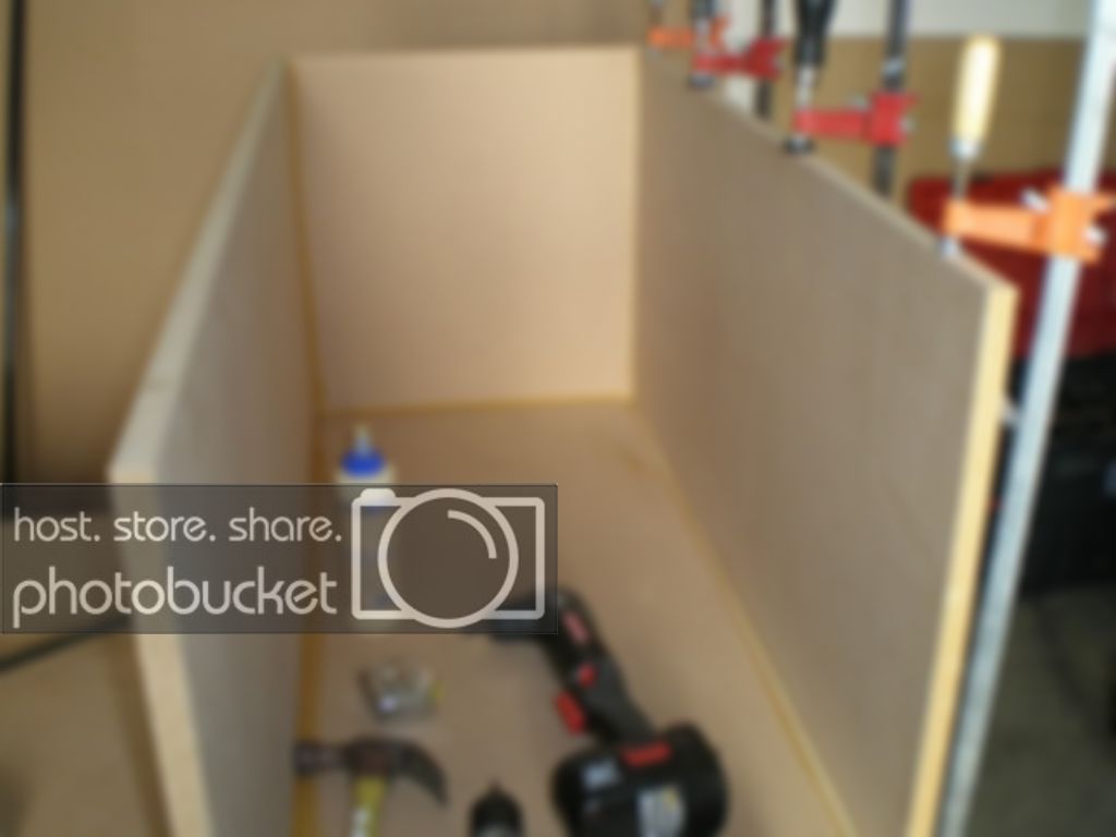

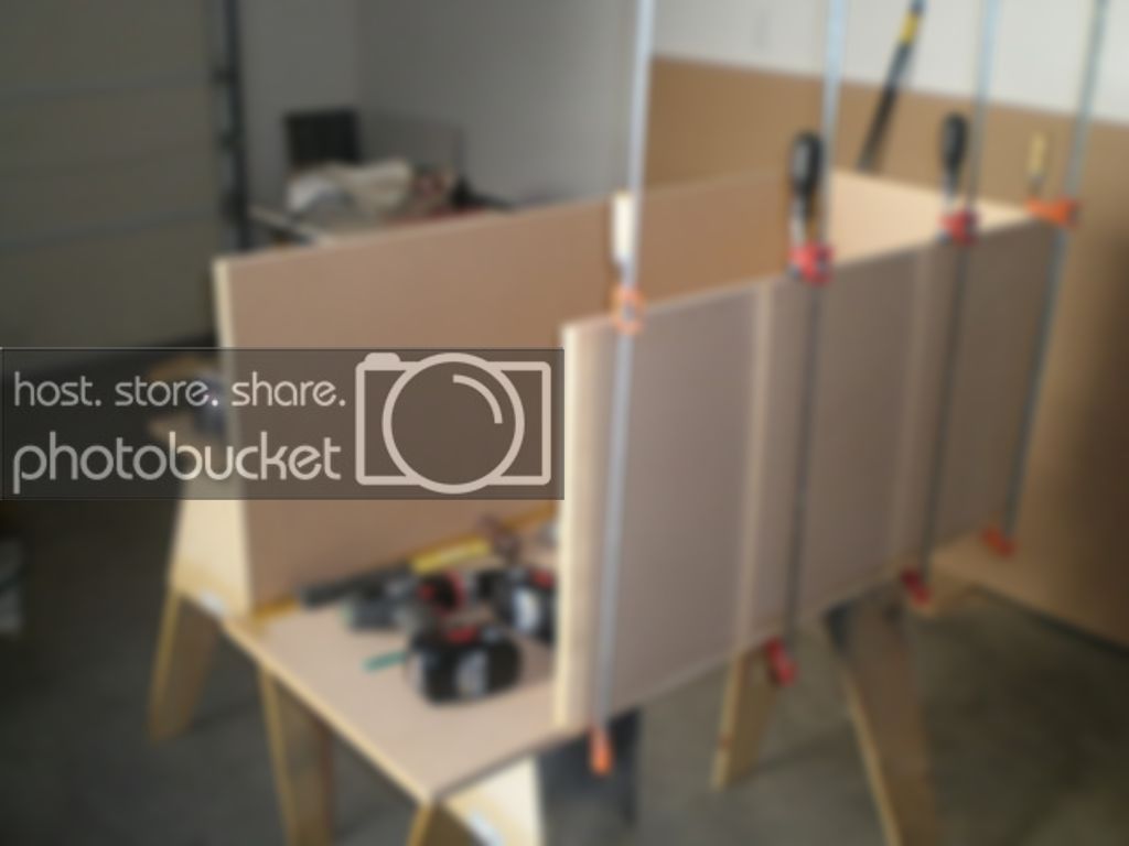

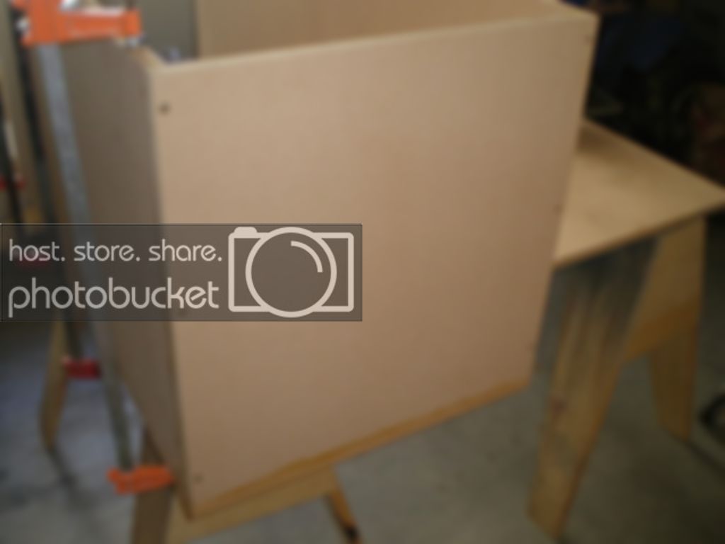

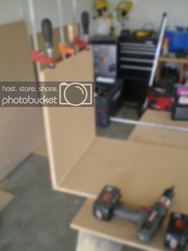

here is a couple pics.

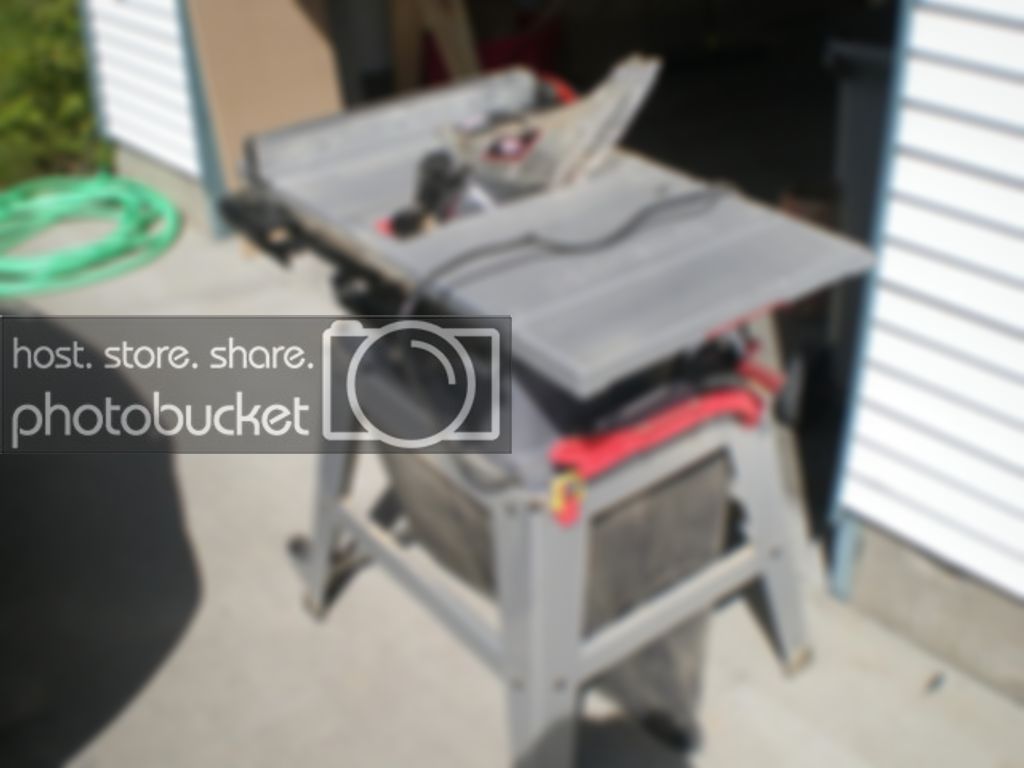

The new toy, which has made my life much easier already:
I've decided to this one screwless for shits n gig's.

Looking at the original design, that box was acting more like a series tuned 6th order than a ported box.
What where the original measurements for that 4-15 box?
If you don't mind, I would like to plot it as a 6th order and compare your in-car measurements to that.

The design is on my other computer, i'll PM you later today.
Id love to get one to peak where you had yours peaking. My van peaked in the low 30s and it was great.
Interested to see how this plays out. I designed a 3 15 ported box with the measurements you gave me for the hell of it. Its all a flat box with everything facing foward. On my other computer, Ill post a pic of it later if you are interested in seeing it.

well, if you wanna peak at 29hz, and get an avalanche, just PM me, i'll give you my design //content.invisioncic.com/y282845/emoticons/wink.gif.608e3ea05f1a9f98611af0861652f8fb.gif
