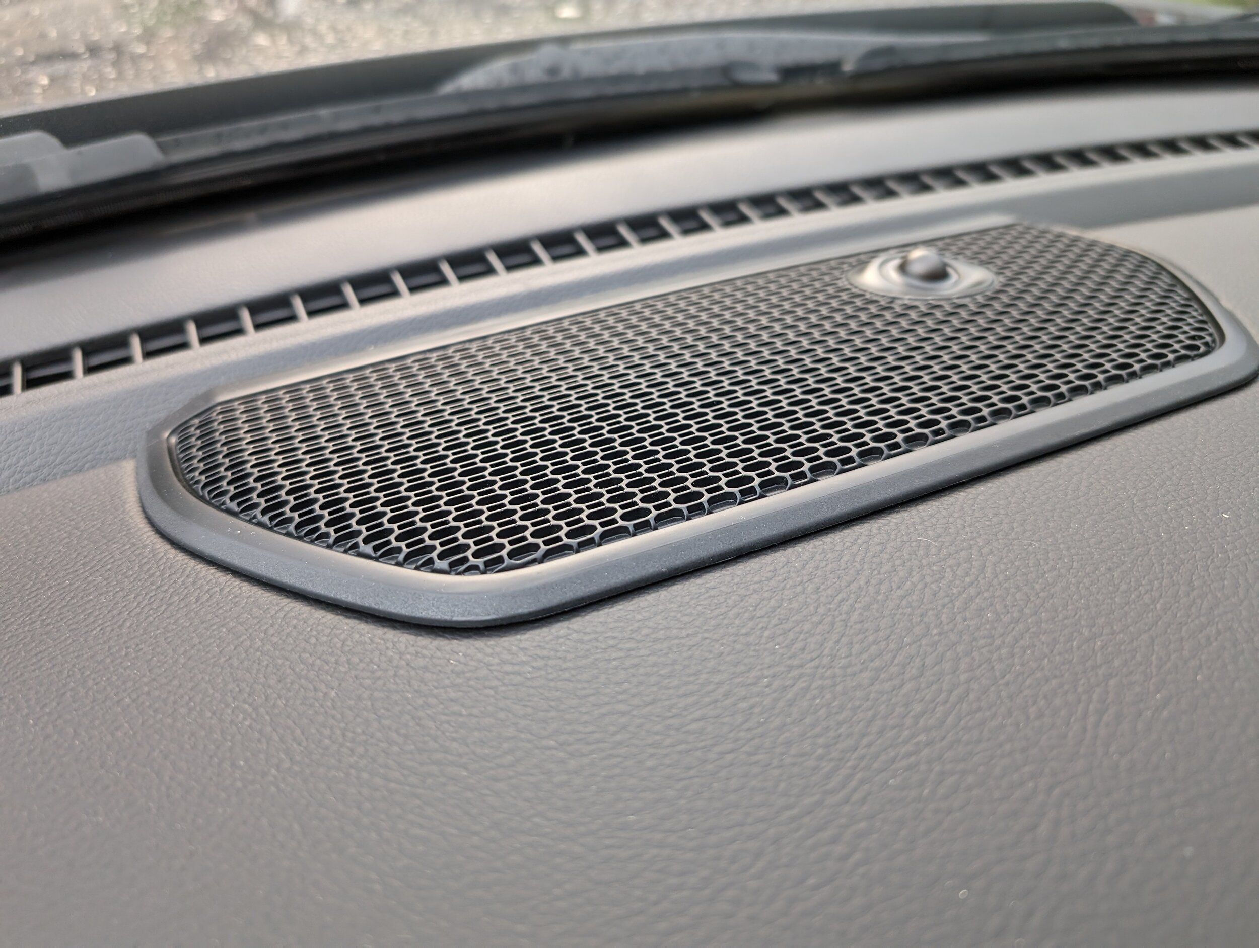

I just got a '23 Ram 1500 and looking to replace the speakers and add an amp. It came with the most basic speaker setup: 6X9 in all four doors, 3.5" in the dash corners. It does have a spot for a center speaker, but nothing in there right now, assuming it won't be necessary?
So I'm thinking components in the front: A 6.5" in the front doors, tweeter in the 3.5" front dash corners. Though would like to know if I should just buy a 6.5" mid for the doors an put something 3.5" in the dash?
