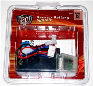

Backup Battery
The first add-on I believe any alarm should have is a Backup Battery. They will keep your alarm going if your main battery is disconnected, so that it will draw more attention. The worst thing you need is an alarm that can be disabled with one cut of a wire. You can find them for about 40 Shipped on ebay, and they will go for about 16 hours if the battery is disconnected. It can power all the sirens, and will basically act as another battery for your alarm.

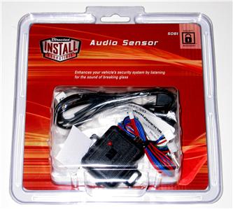

Glass Breaking Sensor
A glass breaking sensor will detect the sound that glass makes as it is shattered and trigger the alarm Some professionals and expert thieves can break glass without causing too much of a shock, making it easy for them to get inside and and kill the brain without the alarm going off. A glass break sensor runs about 20 shipped on ebay, and can be a worthwhile investment if your brain is placed in a easier to reach spot.
