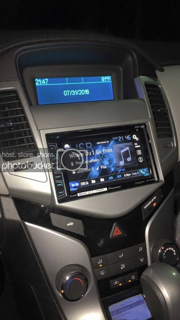

Oh I got you, yeah but Its not about the name either - id go to pioneer too if I knew it was better in my price range. I got the ddx-573 bh for 237$. It's nice so far and those are my 2 top dogs kenwood and pioneer - maybe alpine but have not had one since the cassette days, lol
I was looking for specific features. I know the newer pioneer stuff isnt as nice as the earlier stuff, but It was a pretty good deal. I didnt want to keep hunting for something. If I do change this in the future, it will be for a top of the line audiophile head unit. Certainly this pioneer is better than the oem.

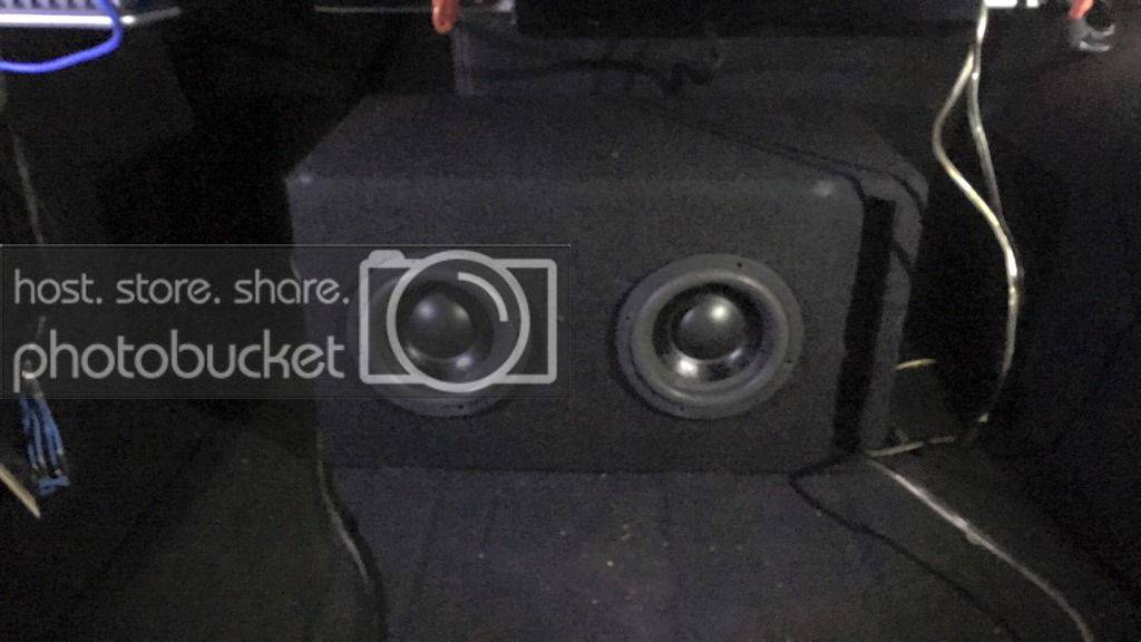

Baby bass Ultra 6.5" subs for the hell of it. 30hz
Choices Choices. Focal 27KX for full time SQ duties. Baby bass for whenever I feel like changing up to ported lows.

lol...so many sub choices to choose from tho...genius.
Want sq? The Focal sub will take care of that. A little more bass/low bass, the twin 6.5s subs....more SPL, the RF will def do that.

The Focal sub is disconnected. The Frosgate 15s are the only subs playing right now.
I took the lil 6.5 subs out. that was just to test. them out. The focal will be retiring also. just haven't pulled it yet.

If you don't mind me asking, how did the aftermarket radio workout for you? Did you lose functionality with some car features? Any unforeseen problems that gave you issues after the install? Does the stock display still show some items, such as the heating and cooling setting when you change them, temp, time etc.? Do steering wheel controls work at all? The reason I ask is because I have the 2012 chevy cruze LS and lately have been thinking about swapping out the head unit for an aftermarket upgrade but I have read so many horror stories of so many problems in doing so. I am decently knowledgeable with car audio but I just didn't wanna get myself into a Pandoras box with it either. I am currently at a crossroad, I have done a loc off the rear channels for the subs but now getting ready to redo/replace the doors mids and highs and add a second amp to the new sets I install. Just trying to plan it all out but debating which way to go, another loc off the remaining channels or upgrade the receiver. Any input you have I'd appreciate. Thanks
