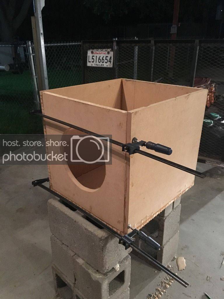

About 6 months ago I made my first box. A 4.3 cubic foot sealed box for a CVR 12. I had Home Depot cut the wood, and I used Titebond III and clamps to put it together. And I used a jigsaw to cut the hole:
I put it in my brother's Tahoe. It sounded great for what it was. Hit the lows good just because the box was so big that the sub moved A LOT.

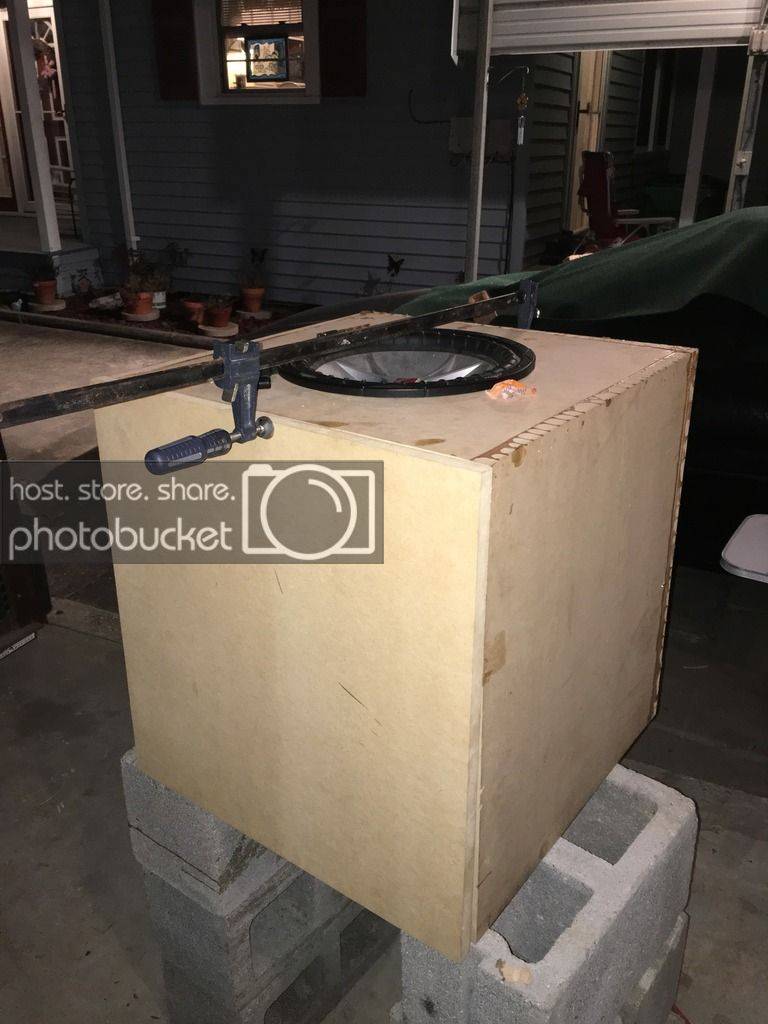

Anyway, after about 4 months of that, I wanted to make another box. This time I built a box for a JBL GT5-15. It's a cheap $70 sub that is now discontinued. I made the box 1.5 cubic foot sealed.
Now things are getting semi-serious. This was the first sub I actually put into my Fiesta. It was pretty loud. But I built the box a little too small. It didn't hit the lows like the kicker did. I thought 1.5 cubes was the MAX recommended size for sealed but it's actually the minimum. I don't think I will make another box for this sub but we'll see.

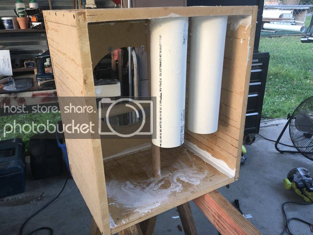

Now we are where we are today (March 11, 2017). I have built my most recent box, a 2.0 cubic foot ported box. It has 2 3" aero ports tuned to 35hz. This was the first box that I cut the wood myself. It didn't come out perfect but it came out better than when I let Home Depot cut the wood. No gaps at all, just the panels are a little long or short, by maybe 1/16". This box was also the first time I used a router, and a jasper circle jig. All in all, I'm proud of this box. It's not pretty but it bangs!
http://i86.photobucket.com/albums/k107/SantaOMGProd/615FF0CF-2AE0-443E-9927-71DD42BDF3B6_zpsadlnh5wd.jpg (link because image limit).
I have replaced the Kicker CVR 12 and my pawn shop amp (400 watts) with an SA-12 and a pioneer 1200 watt amp. **** really does get down for what it is. And I have now positioned the box to where the box is right next to the passenger side wall and the port is aiming right at the corner of the hatch wall on the passenger side. Now my wipers move a little and I can float a receipt in the window a little bit.
