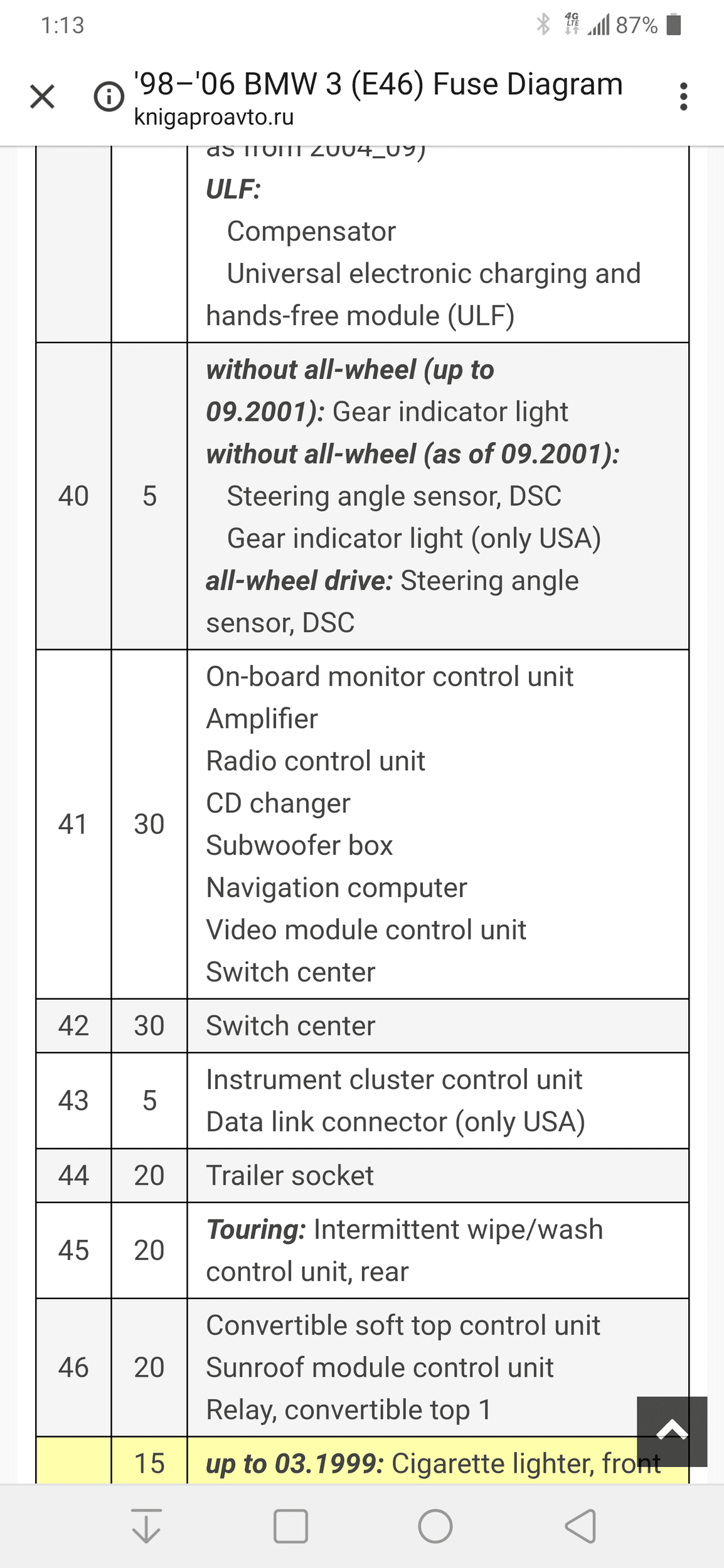

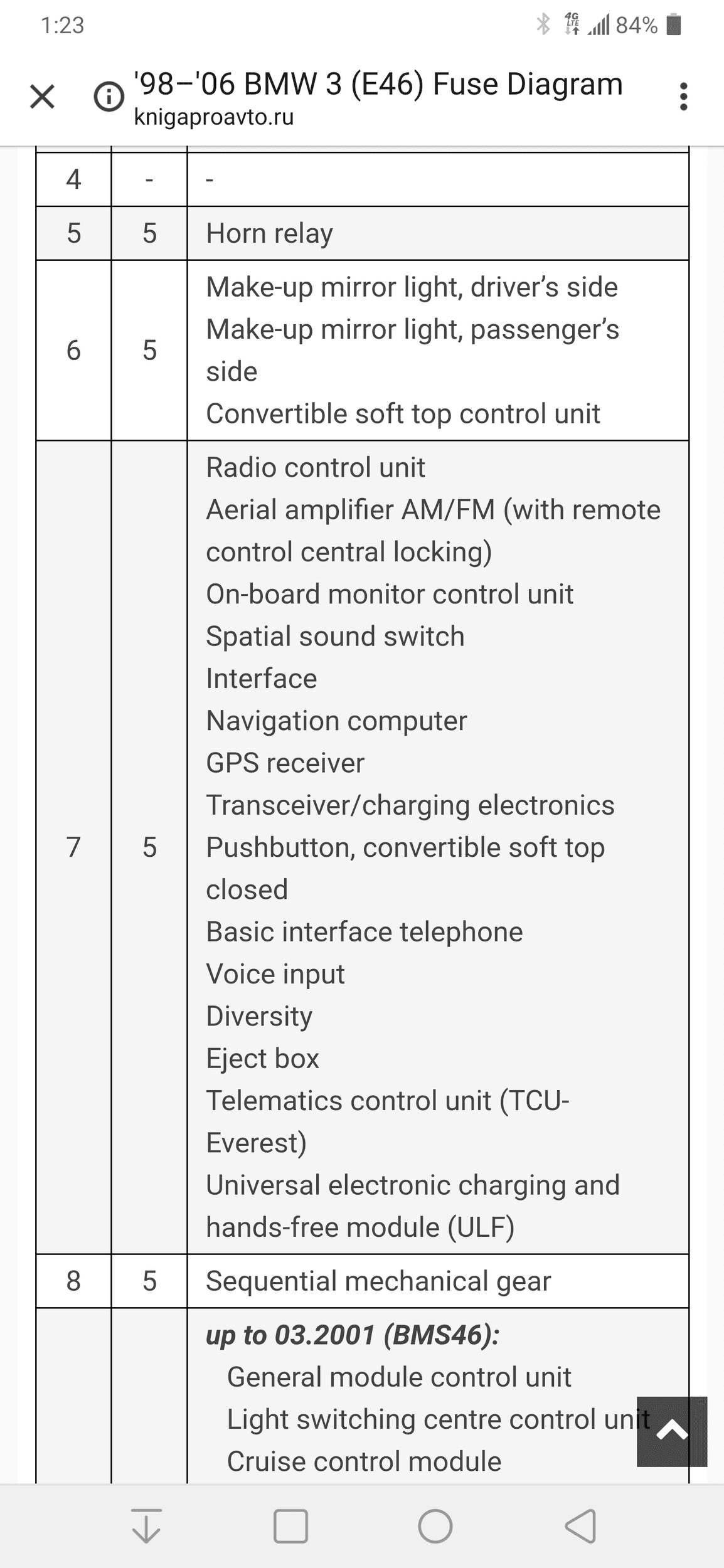

I would connect the amplifier's remote wire to Fuse #7 or Fuse #41. They are both audio power sources. Fuse #7 is only 5 volts, but remote circuits require very little voltage to operate.
