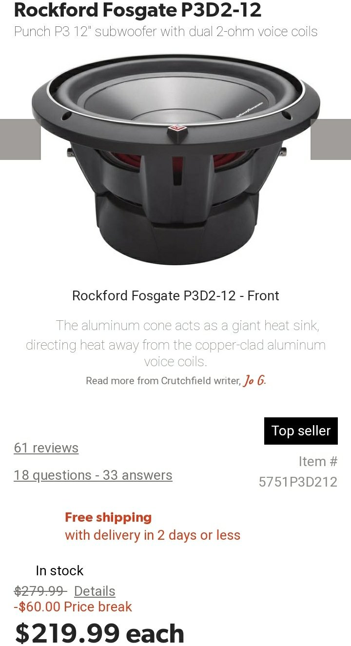

Actually the P3 would be a better choice IMO.
