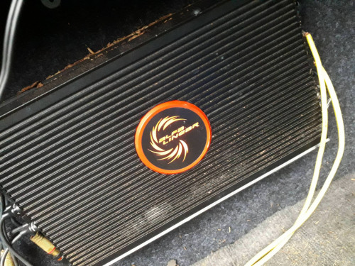

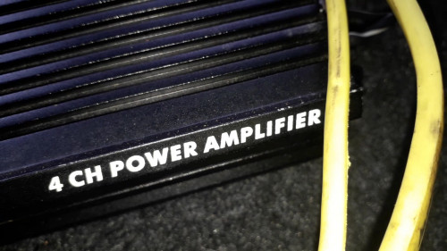

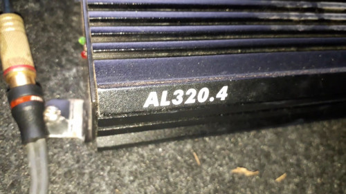

Hi, i have this amplifier (Alfa Linear AL320.4) in my car, the previous owner installed it, but the subwoofer isnt working. The amp has power going through it, so its still fine. Any ideas on what subwoofers supports the amp? Not sure how to select a subwoofer for the amp since there is watts and ohms matters.. It would be nice if you include what to check for when buying sub for this amp. Thanks.
not an ideal sub amp really unless you get 2 dual 2 ohm woofers and wire them up to 4 each, but even then, youd be getting a small amount of power. SoundQubed has a 800 watt amp on sale for $100 and you can get an american bass xd series 12 for around 80 or so
previous subwoofer was 4ohms, wired in bridged.

the subwoofer is the problem, i have checked it with 9v battery, no reaction. Plus, the subwoofer is Kicker brand and very old. It says 4 ohms and the model number, i cant seem to find any specification online with that model..

Yes, i have already checked with 9v battery, nothing happened. The amp's power led is lighting up so amp is probably fine..
Hey mate, as I suggested, although the amp lights up, you still need to test the rear bridged channels to a speaker. Once you know its all good, then go and find a subwoofer to suit your needs and budget.
