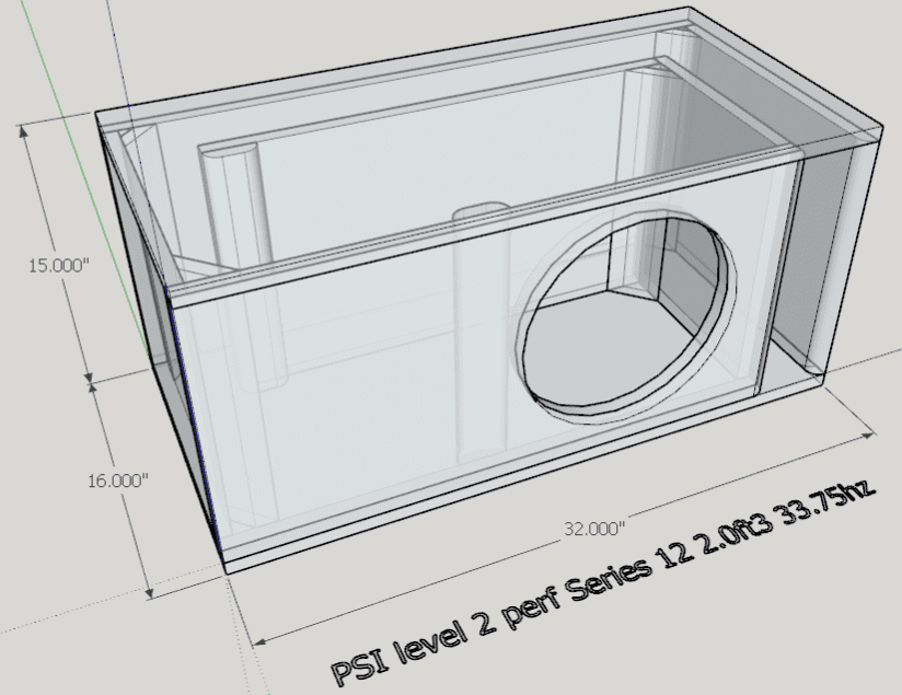

Thats a pretty picky box to design... decent port area and pretty long length just to get a lower tune in a smallish box... I had fun doin this one...//content.invisioncic.com/y282845/emoticons/rage.gif.0ad8a6e5565b5fddce406566fdd05149.gif

What software did you use to create that? Yes That quote early was a stupid mistake on my part lololol. I have bass box pro, the reason I'm not designing my own enclosure is I'm busy with work all the time so I just paid someone to design it.
Winisd/Torres and ol' fashioned calculator... it's ported for that 2500 watter at 1 ohm btw. I see no reason to build the box for less power unless you're really limited on space.
That sub looks pretty capable... I'd put the power to it and be grinnin if it was mine btw.
