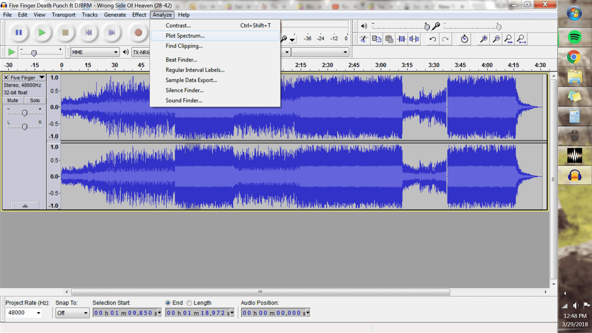

Temperature, and knowing how loud your max clean output is via testing and adjusting everything accordingly per song played is called active gain setting which is what all the pros do. I'd advise you to download audacity, use the spectrum analyzer and see the recording levels of bass in several of your songs to get a feel of what you should actually be shooting for.
^^^^^^^^^^^^^^^^^^^^^^^^^^^^^^^^^ shows -3 db at 36hz which means if I set the gain with a -10 db tone, I'll be clipping by 7 dbs worth which equates to quite a few clicks to my sub level. However if I set it with a 0 db test tone, i'll be losing out on -3 dbs worth of output. which is a notch or two down on the sub level. Literally proof of why setting gains with test tones is utterly beyond useless.
