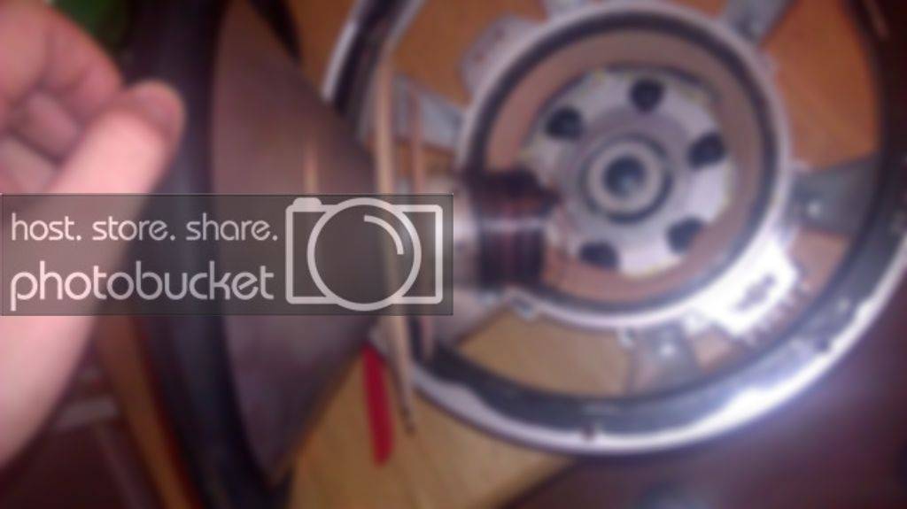

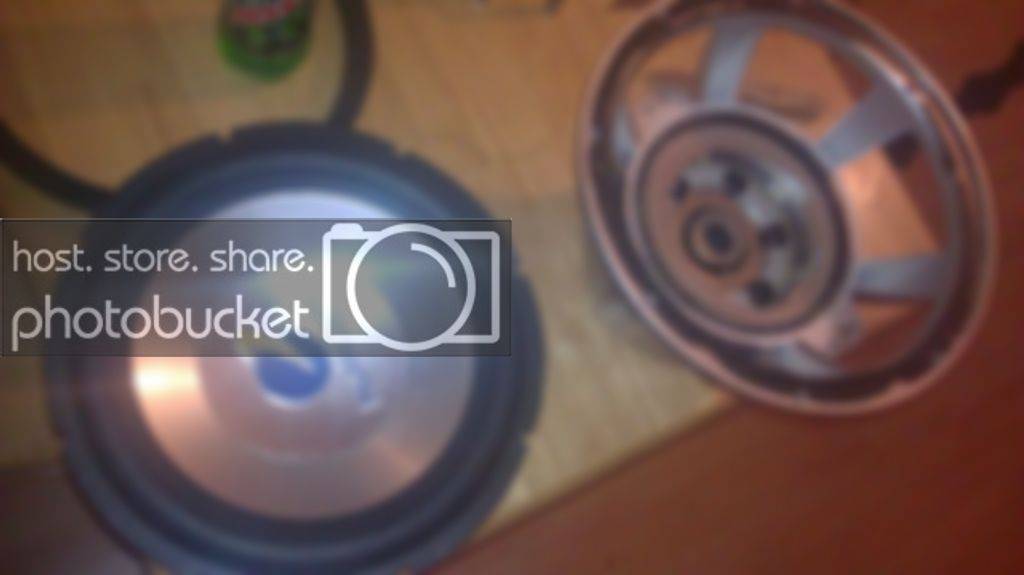

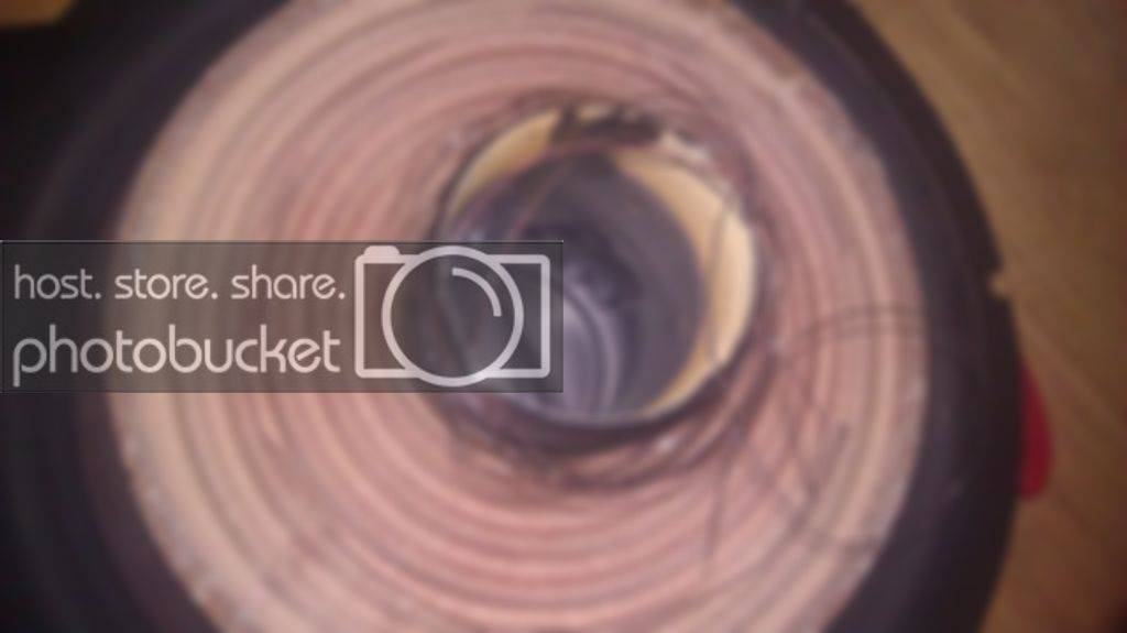

Well I tore down the one I know for sure was blown...
I mean I don't know for sure but I think the old beast is A-OK. //content.invisioncic.com/y282845/emoticons/thumbsup.gif.3287b36ca96645a13a43aff531f37f02.gif
Oh that old girl was toasty.
I took it apart gingerly so everything except the second spider is %100 intact and then I unwound the coil. I had the crazy idea of just putting it back in and using it like a sub reverb since the other two subs push it like if it was still working. That way it would save me from having to make another box until after the other two blow or I get more expendable income.
