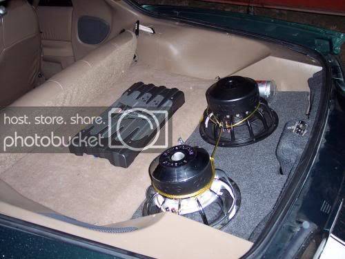

Well you don't have much room to work with in the hatch, but you might squeeze 3 8's in there. They are (camaros) loudest facing up at the rear window of the hatch. Or wall it off behind the headrests, that works too. The loudest I ever had was 2 good 12's sealed on 1500w and it was retarded loud in a camaro. Same setup in an explorer= not so much.

If you can fit two twelves back there, you can fit 3 8's, you'll need a MAX of 1 cube per sub for a ported box, you need 1.5 - 2 cubes per sub for 12's, so you have plenty of space.
I had the same box in that pic. See if you can get something similar to that built. Also the aq2200 is a nice amp. Have one myself. Thats a big wibdow. Be careful and dont blow it out lol
