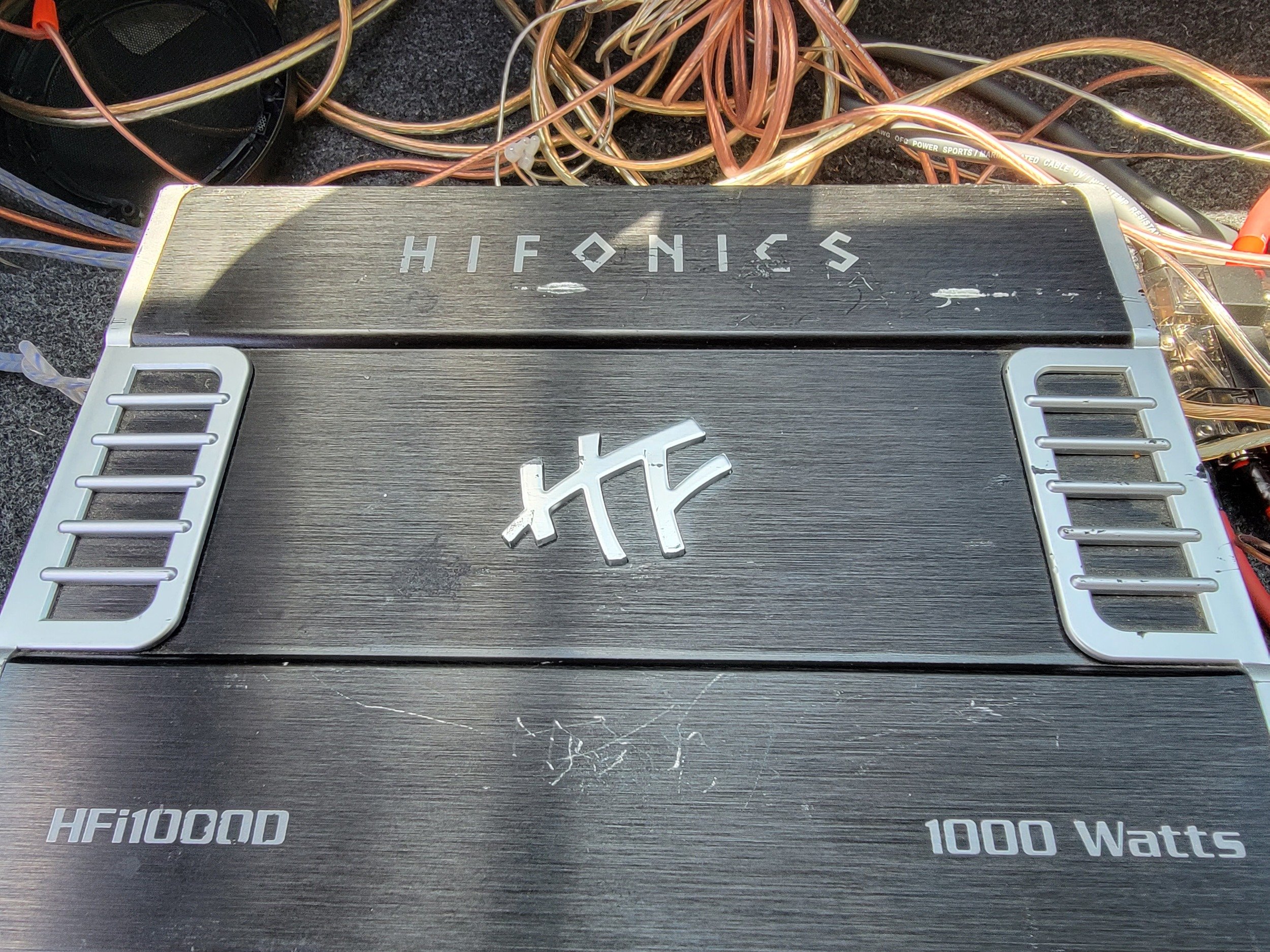

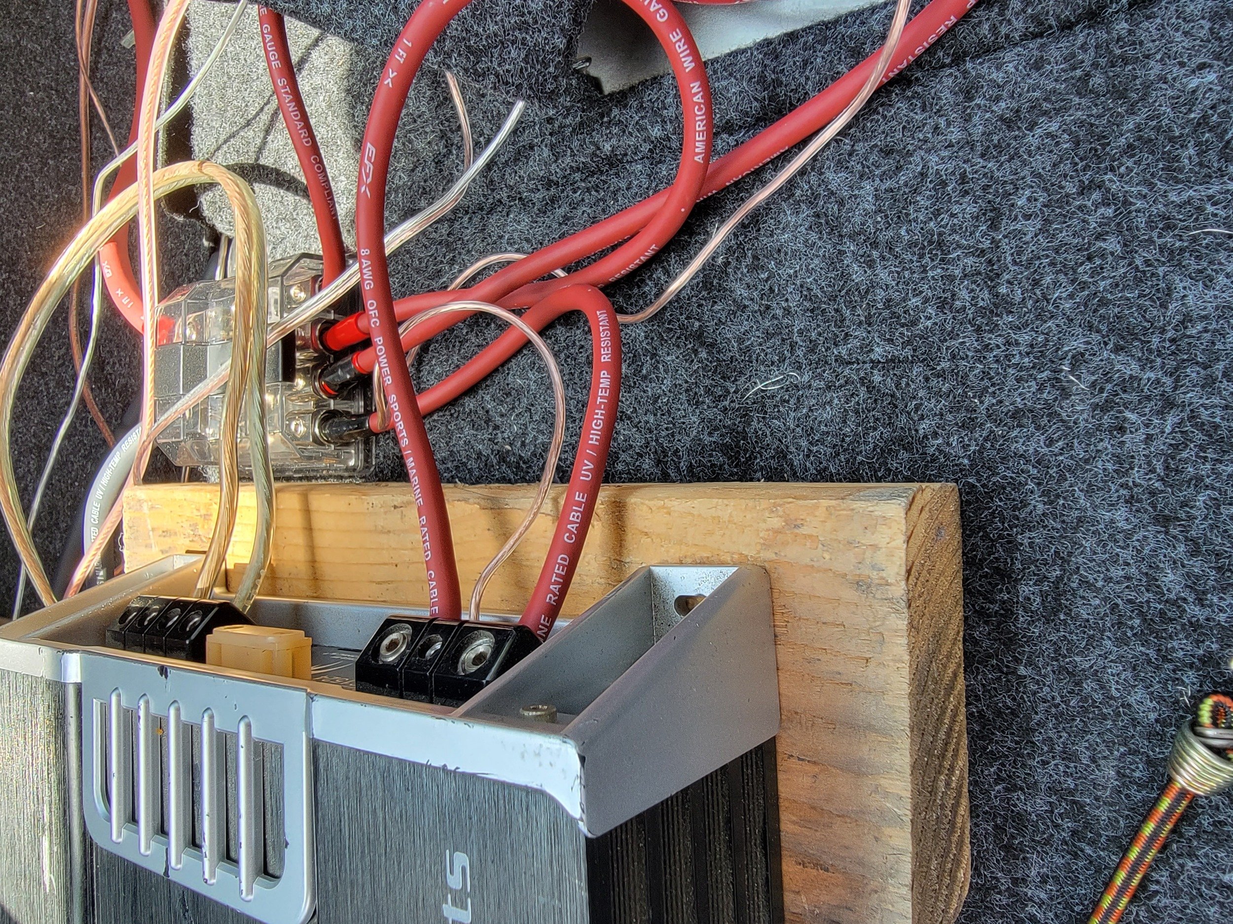

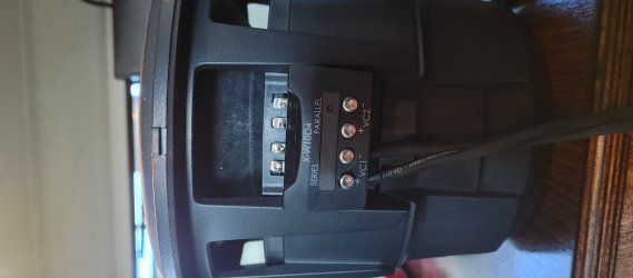

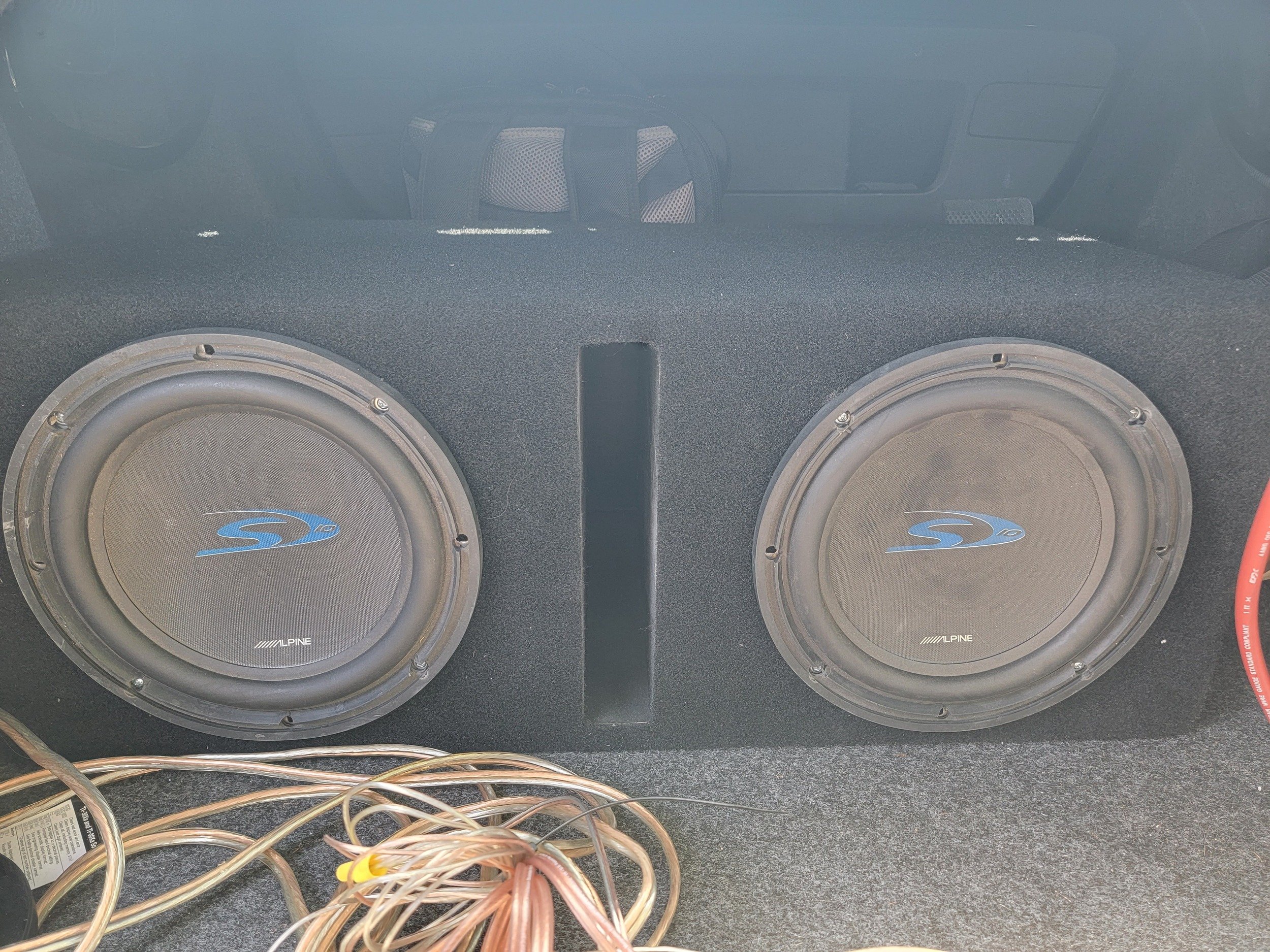

Push down easily on each sub and see if you feel any resistance / and or feel any scratching. Pics would be nice. What subs do you have and what amplifier/amplifiers?
Since we're on this subject. Sorry for a rethread but man i blew my 10" sub because i feel i had some exposed speaker wires that touched together(+,-) and caused a short or something but when i press down on the sub. I get the scratching =[ it sounds real nasty. And because i still have it in the box when the 10" sub survivor hits. The air passes through the burnt one and has me scared thinking its now happening to the other.

So i got a refurbished amplifier back from kicker and when i hooked it up i checked for dc voltage at the speaker terminals and i am getting 56 volts of DC on the replacement amplifier...
Now the amplifier next to it works perfectly and is wired exactly the same... Am i unlucky enough to get a refurbished amp with the same symptoms as the amp i sent in?
I checked the s/n and it in not the amp i sent in for repair.. The referb is actually showing the 56v dc even when the amp is off. Anything i could be missing here?
That is peculiar, I would contact Kicker immediately on it and have them run through any tests, that way they can't say you sat on it for months and damaged it yourself, and remind them you have a working one installed next to it. I know I suggested it before, but you could also post over a diyaudio (link below) as there is a Kicker amp technician that helps in the car audio section when he is able to, along with other highly skilled amplifier / electronics techs.
