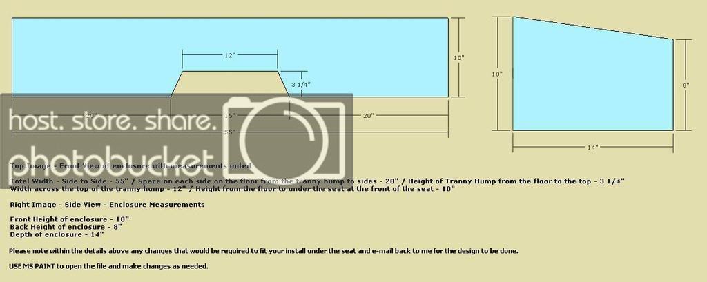

I believe it is this

Ya I just saw those on woofersetc as I was going through the 8" subs. What would I do for a box tho? Also JL makes that high output box that is just about 10" tall, may be able to fit that under the seat too?

You could actually get away with just doing a regular rectangular box on one side of the transmission hump and accomplish it I bet. Would avoid the hassle of building the box to accommodate the hump.
if i understand it right u could do just 2 small boxes on the left and right of the hump.
20 wide, 10 high, 14 depth is easily 1 cubic foot, problem is doing a slot port is going to be hard to tune low. might have to go aero
Could do a box on one side with the dimensions posted by Cruzer and do an external aero port firing over the top of the hump. Then lay a piece of MDF on the other side of the hump and bolt it to the floor and mount the amp there //content.invisioncic.com/y282845/emoticons/smile.gif.1ebc41e1811405b213edfc4622c41e27.gif
