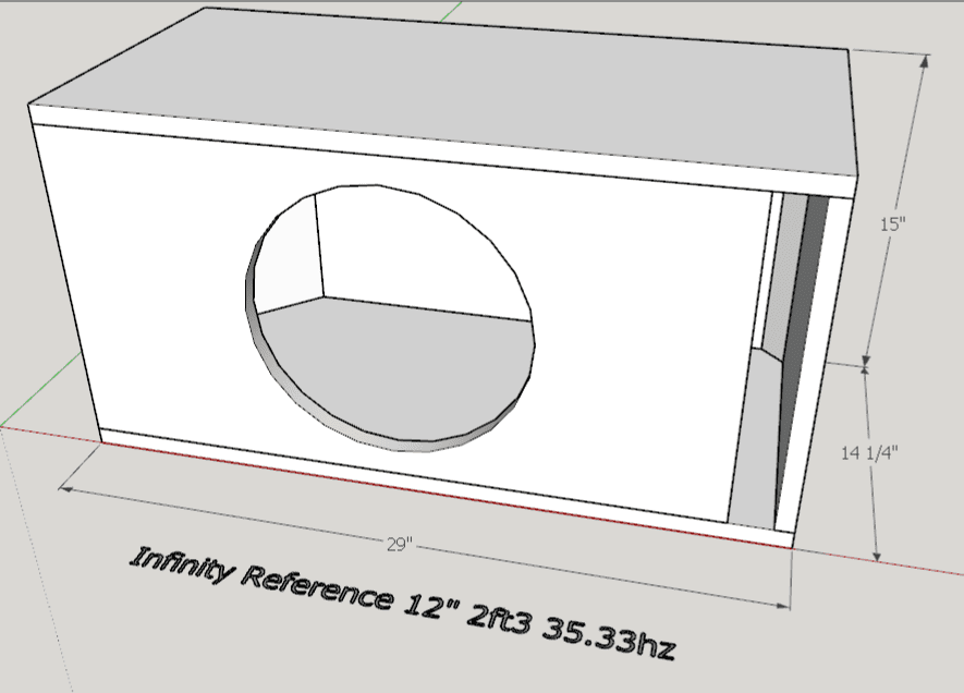

Hyundai Veloster
Trunk is empty space is not an issue
Infinity reference 1250w 12 inch sub Manufacture states min/max is 2.0 cu/ft
Ported
I listen to a wide Variety of music rap,metal,hip hop
Just need something simple
3/4 mdf is what I would use
Hyundai Veloster Trunk is empty space is not an issue
Ported
All good info... whats your width so I get a maximum available idea and preferred height? Also, I'd like the actual amplifier/load so I can try to do this right for ya... I can do simple, no problem. I'm assuming a mid 30's tune... correct? Now just lemme look for parameters while you get measurements.
Rms is 300wAnd I have 37x30x18 to work with I don’t want it huge but you can do as needed to get the 2.0
No problem, looks like it'll be single baffled, 15"H x 34"W x 14.25"D... about 35hz tuned, sub and port back if that works for you. Lemme know and I'll send ya a PM when I whip it up.
PM sent
Resized it a little... should work fine.
