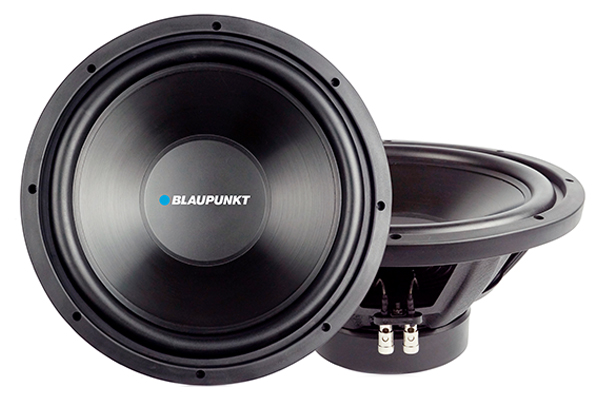

Your indicate you’re budget is equivalent to $300 usd. A couple ideas
Two of these in the 10” version in ported wouldn’t consume too much space and be easy on electrical
