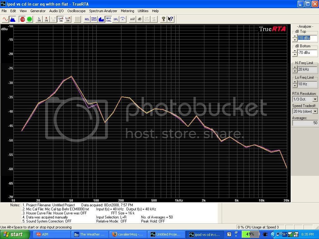

i wanted to see if there was a frequency response difference in car between using my ipod and using a cd.
-first i must say, DO NOT pay attention to the actual response, the mic was simply laying in my lap while i was sitting in the drivers seat. but, it doesn't matter since all we are doing is comparing two different sources with each other.
-this test was done with the same pink noise track, one on a cd, the other on the ipod.
-the HU used is a Pioneer 880PRS
-the ipod used is the latest generation Ipod Nano
-the ipod was hooked to the HU with the Pioneer "CD IB100 II" interface
-the EQ in the Ipod was set to flat. and yes, it does matter, even when using the dock port. i quickly picked a different EQ setting in the Ipod and the results did change.
i must say i am a little shocked at the results, but they don't lie. you'll see the only difference is a measly 1.4db difference at 80hz. i honestly don't even remember which line is for the Ipod and which is for the CD, but obviously it makes no difference.
so if you are hearing a difference between the same music on a cd and the ipod it is not the Ipods fault(unless you have the EQ on anything but flat).
***i also just realized that on the EQ on the Ipod source on my 880's EQ i had 80hz cut one step. so that explains the slight difference at 80hz.
soooo, that means it's exactly the same!!

yea, me either. i could have sworn i was hearing slightly less on the tippy top end when using the Ipod. but i guess it's either psychoacoustics or the mp3's themselves.

i'm not proving that they won't sound different either. don't think i don't know that. i am just proving that the response is the same on paper.

what i wanted to test is the ipods frequency response along with pioneer's ipod interface. i figured there would be a difference.
i am in no way shape or form trying to say an MP3 on an ipod will sound the same as a cd. i'm just saying that the frequency response of the ipod and the pioneer interface is dead flat, which is sorta shocking IMO.
so kudos to apple and pioneer.
