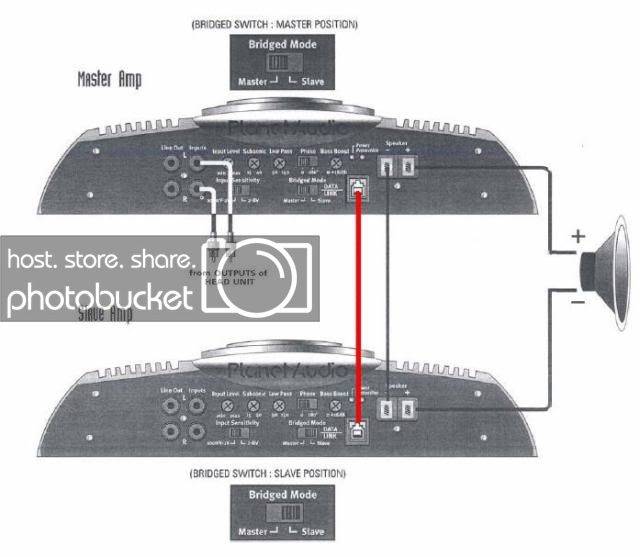

whent to connect it like this, using a normal 4 strand rj 11 telephone cable
and as the manual states
did not get any sound from the amps and the Master one was with the on and protection lights on the other one just power light on.
remove and conect the rj11 cable and something f***kt up, on the slave amp you know tha sound and smell //content.invisioncic.com/y282845/emoticons/mad.gif.c18f003ab0ef8a0d9c27ca78d77a6392.gif, the i connected every thint to normal only using the master on and whas ok.
what did i did wrong????,

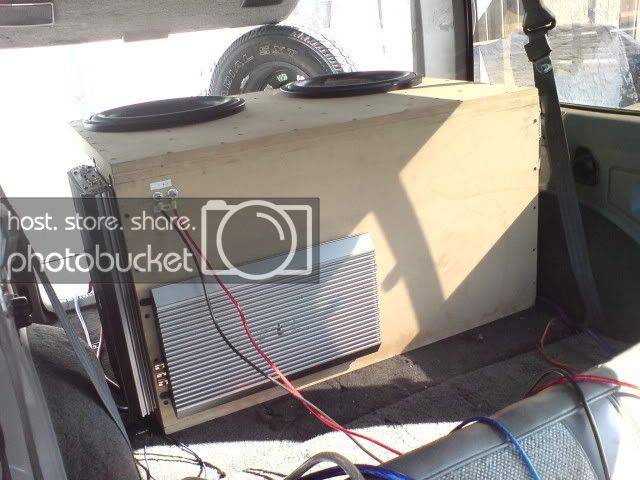

are they both the EXACT same amps, they look different from the pic
They come with a strapping cord new, you need that.
they are the same, just picture angle,problem is that i got them used for a good price //content.invisioncic.com/y282845/emoticons/smile.gif.1ebc41e1811405b213edfc4622c41e27.gif,i emailed Kole audio and they told me that any 4 strand patch cable will do.

I have a Kole Audio QX1-3000D and a QX1-2400D and they are the best amps I have ever come across.
The amps I have came with a patch cord to strap them together (with another amp of the same rating) and it says, and I quote,
"This wire is only for bridging this amplifier, not to be worked for telephone"
Now I am not saying that you can't use a regular phone wire but it kind of makes me wonder when they say you shouldn't use it for a telephone. I would think it should go either way.
Also, the guys at Kole audio will tell you they are only good to 2 ohms when strapped (because this is putting a 1 ohm load per amp). The paperwork that comes with the amps also states this. When they are strapped, it must be hooked to no less than a 2 ohm load.
If you have two subs with 2 ohm dual voice coils you can achieve the 2 ohm rating or 4 subs with dual 4 ohm voice coils, etc. .

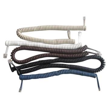

just tested both amps and they are working fine now i am worried about the patch cord that i am using.
gmltwc can you take a picture of your patch cable?? just for reference to check if its the same as mine or to make one
