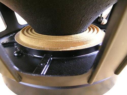

Do you have a Digital Multimeter? You can check if its blown by using the DMM, most cases if theres "rubbing" the coils blown and is rubbing.
With the sub out, maybe try pushing gently upwards underneath the cone and look at the joint where the cone-spiders meet if theres any gaps that could be an issue too.
The tan object is the spider, and its glued to the cone
spider is fine and used very small pressure to test.
