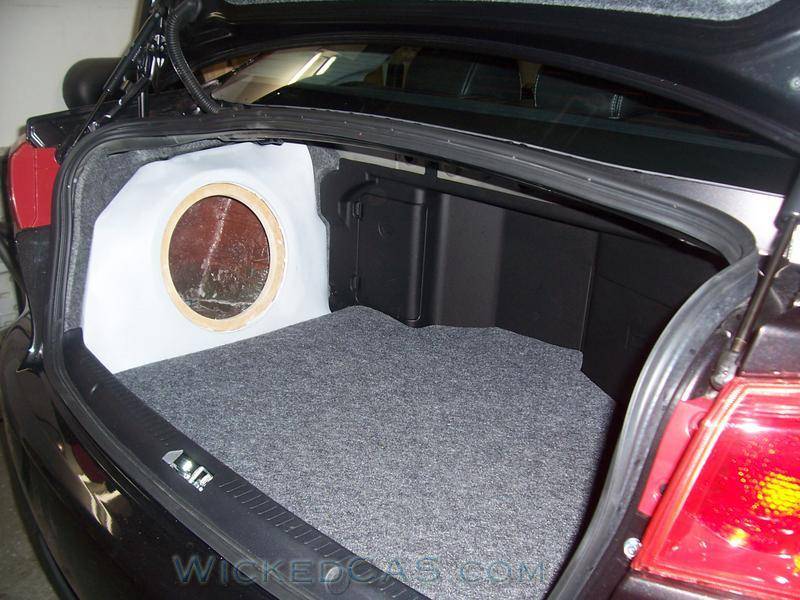

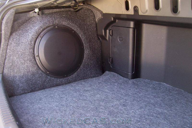

Just by replacing the subwoofer with another one isn't going to make a large difference. Especially on only 150W RMS. Sure, it's a nicer subwoofer, but it's going to be receiving the same amount of power. Also, a ported box would do that W6 much more justice than the little form-molded sealed stealth box.
oh yea, no doubt. I am going to pick up a JL 500/1 amp too. I am also going to get a bigger 0.9 cf box that goes in that location.
I know a ported box would probably make a much larger difference, but I think with 500w instead of 150, and a real sub in a larger box, will definately give me some decent bass.
I was going to grab this enclosure.
