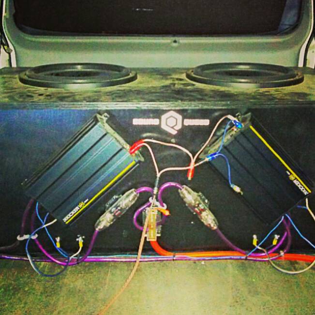

Number 1 cause of amp death is vibration damage and then low voltage. And strapping amps or gain matching both svcks. I would sell and get 1 big amp.
Was going to say the same. Sell them and just get 1 amp. And mount the new amp somewhere besides the box
Don't a lot of people using them do arpund 1500W on them? Heard many say they will handle 2000, too. And whys it bad for the mounting amps on the box?
People say all kinds of things on the internet, but I would be willing to bet that a 50hz sine wave of 1500W clamped power will hurt one of those subs in under five minutes.
Vibration from the box is very bad for printed circuit boards. It is indeed a leading cause of amplifier death.

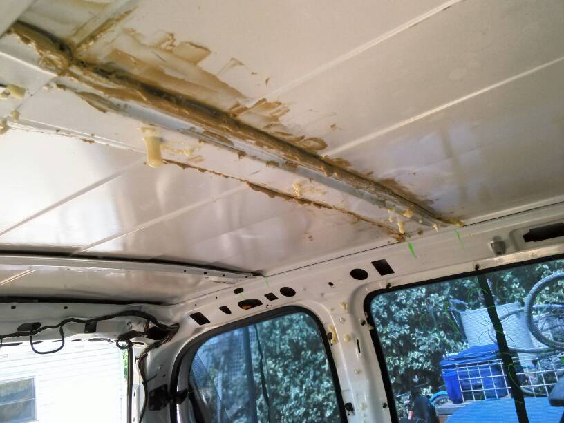

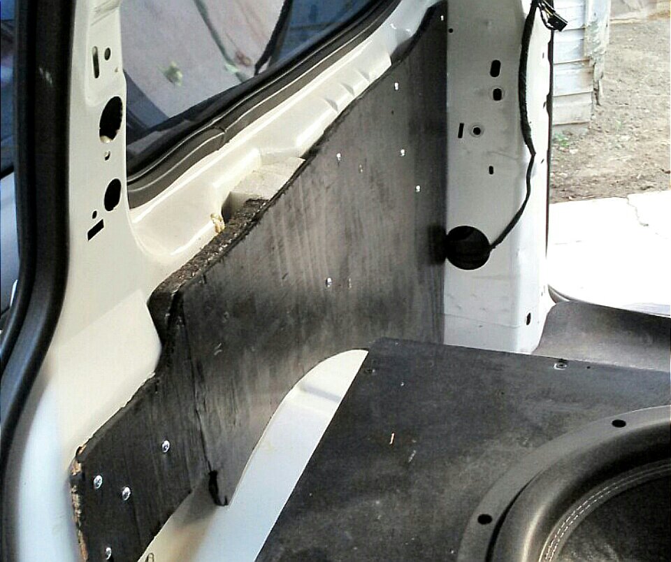

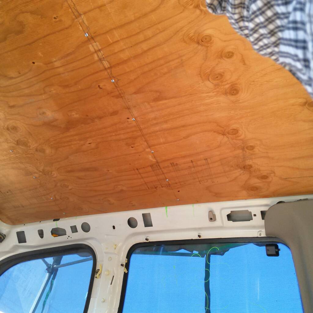

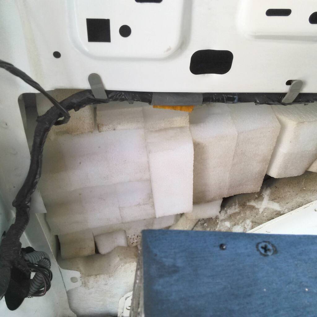

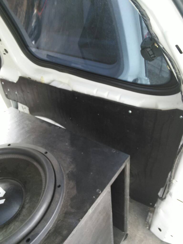

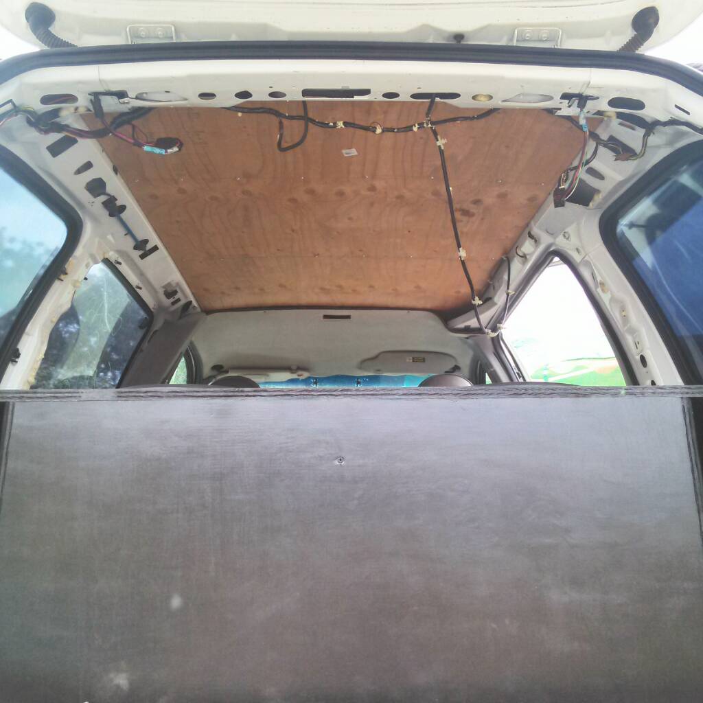

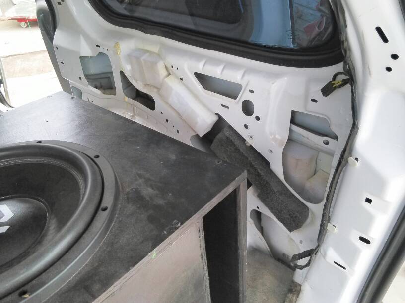

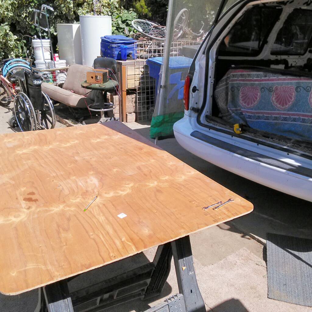

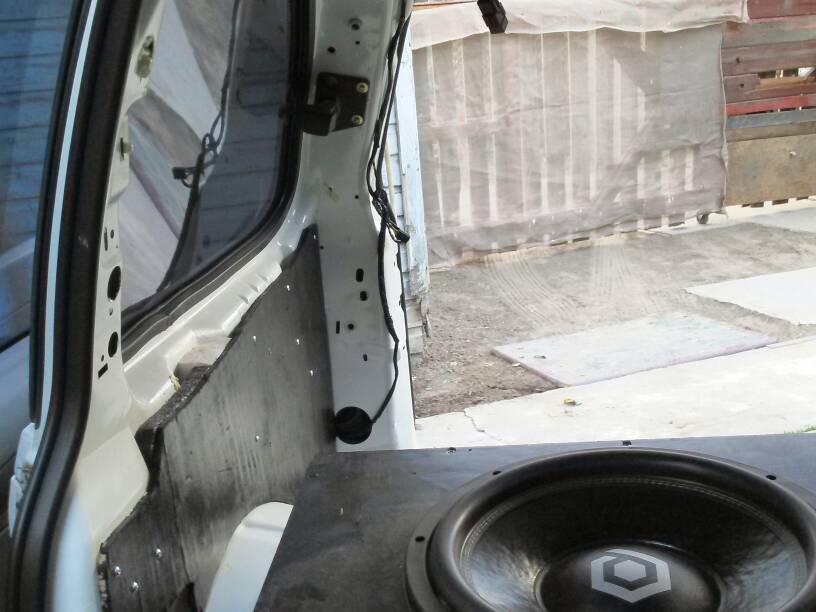

I've plywood the roof, even used what was left of the sheet of ply to make panels for the rear sides (cargo van) and cut some thick foam I had from packaging materials, going to stuff it with great stuff foam tomorrow. I haven't yet stuffed the roof yet.
Tried a different option for setting the dual amp gains. Instead of setting with x'over at 70-80Hz, I used 200Hz @ 50.9 volts each amp since I have one of the birth sheets rated for 1284 on one amp. Volume 31/35 bass 0db, sub-level 10/10.
Also pushed the box further 5-6" from rear. Using 200Hz x'over set the gains lower at around 30-35 Volts. Using the bass level on the Kenwood ddx771 and this shid is BANGING WITH NO MORE CLIPPING!! Okay maybe I am clipping since I've been playing decaf at 31-32 head unit volume, varying the bass in different tracks around 0 - 5 level. Sounds 200% better louder cleaner tighter and the cones stay cool. Can even notice the in-sync moving of both subs and not working against each other. They hardly move now the clipped signal I was pushing them before. I'll post pics in a min.
