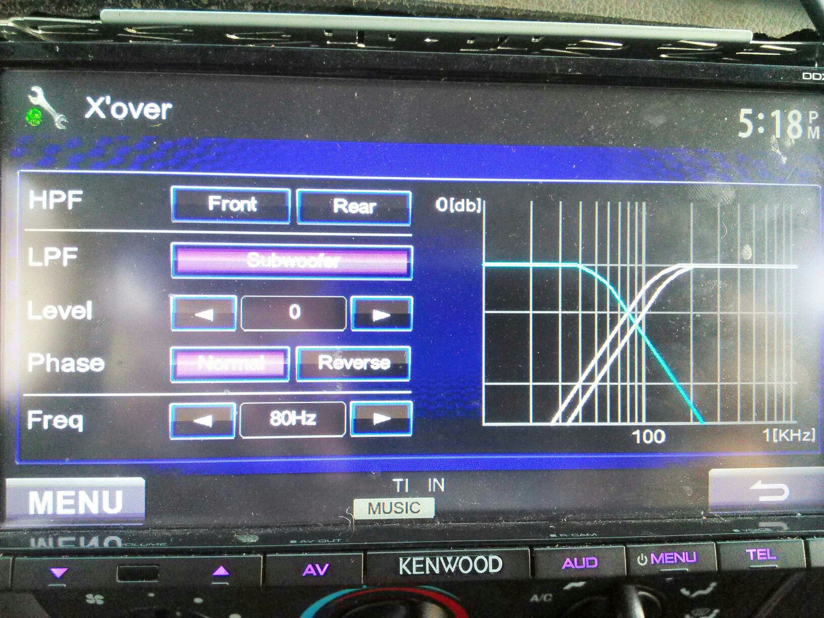

I've set my gains by dmm after experiencing the coils heating up from clipping so I set gains by DMM @49 volts per amp with the 50Hz tone burned to CD, 0 sub level / 0 bass freq. 27/35 volume on HU with LPF 80Hz on both HU and amps. First time doing this.

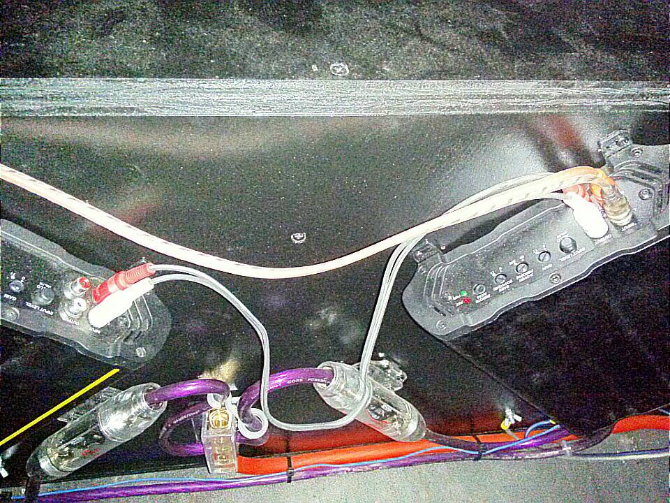

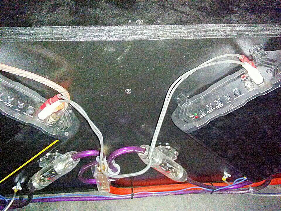

Still trying to find a peaceful place to meter it. BUT! I switched the rcas to the other amp and the other sub is moving more. So this is something else, no?

likely have a bad RCA if thats happening when you swap rca cables on the amps.
You know I missed seeing your post, here. And right now when I read it, I was gonna say that it is the same rca cable that (the main sub output cable coming from the deck) I am using. I'm sorry what I meant was I unplugged the main from amp 1 and plugged into amp 2 - pic #1 & #2 shows the switching I made w/ thee RCAz -->> b4
aftR
Now what I'm thinking is bad rca cable like you say. The other day I pulled my deck out to plug another set of rca for my front stage amp and noticed the sub preout rca was really tight to where I had to reach in with my fingers and pull them out before I could have the deck out of the dash and I was trying to be as careful as possible. I might of stretched them to death. Make sense? Im trying a different rca cable for the daisy chain set in the mean time.

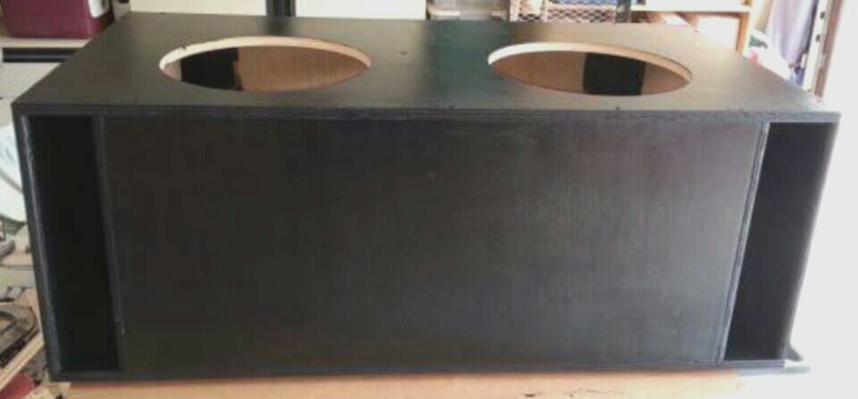

Where is the box ported? Subs sharing airspace can load different depending where they are in relation to the port.
