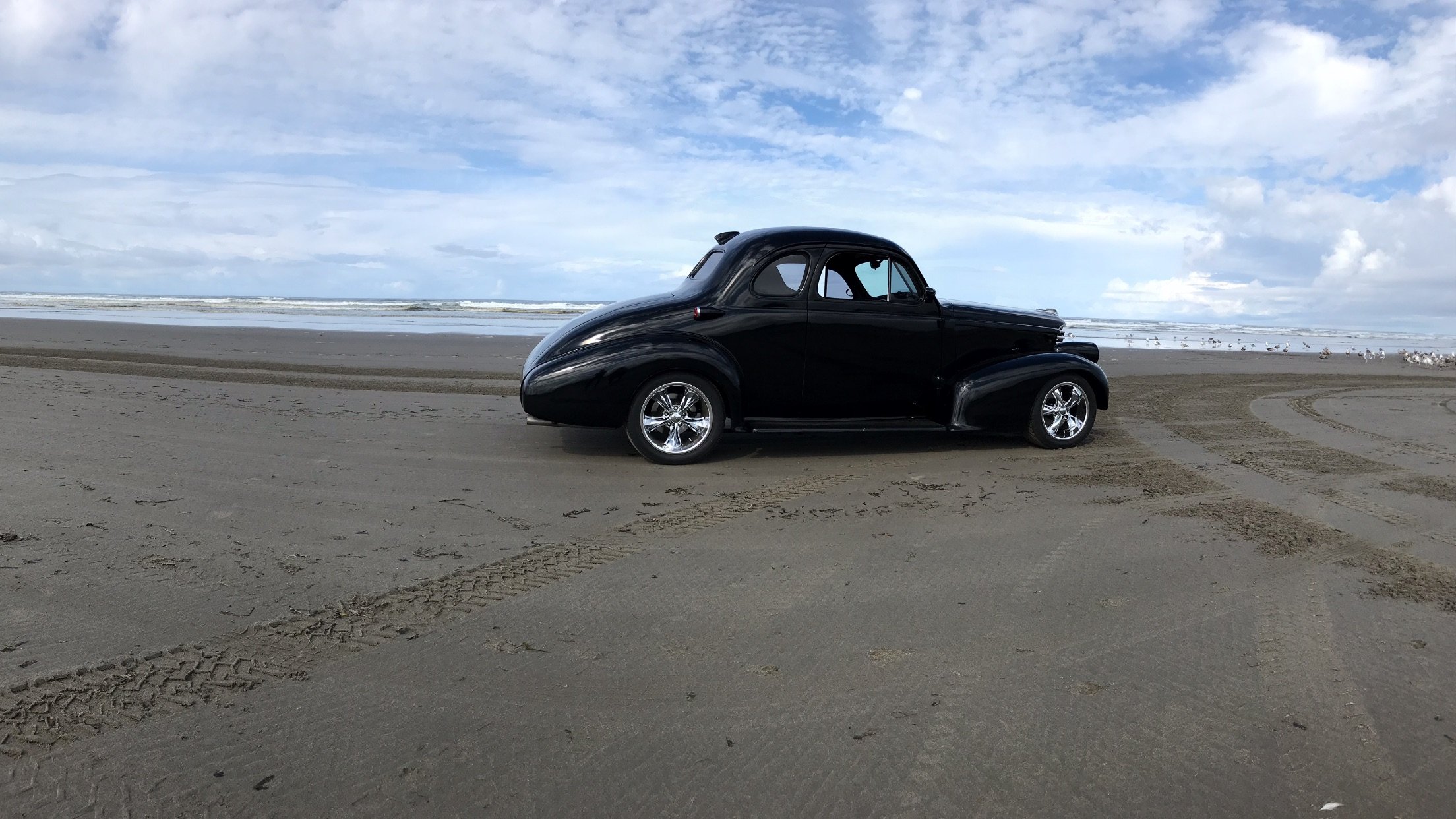

So I went out and baught a new ra60f alpine 4 Chanel amp to run all my frount and rears and so far keeping the punch 40 for the sub in my 1938 Oldsmobile business coupe
22557
Oh yea I baught new speaker wires and new extra shielded rca’s and new power and ground and remote wires. I’m still not finished installing every thing I had some aluminum tape so I went over all the rca and speaker wires under the carpet. Since some people said to use aluminum foil.
The rca and speaker wires only cross the battery cables in one spot no avoiding it the power wires run down the center of the car from the battery in the trunk through the center console area to the fuse box to power it and ground it.

That's one sharp Olds. I have never heard the foil method, but there are some rcas that have it integrated so there is something to it. The Punch40 is 160w rms @4ohms bridged while the the t400-2 is 400w rms @4ohms bridged. I do not see how the 40 would sound about the same as the t400. Good deal on deciding to rewire the whole system. It is always a plus refresh grounding points and splices. Update us when possible.

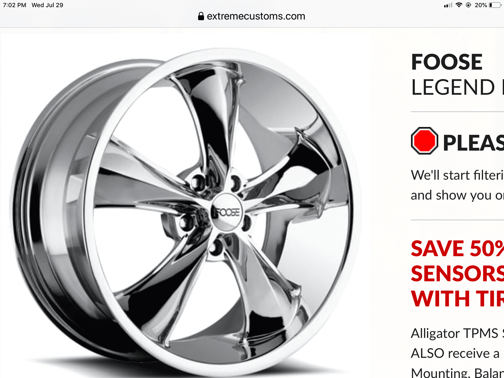

Btw, are those Torque Thrusts on the Olds?

The rims are Foose legends 275/40/17

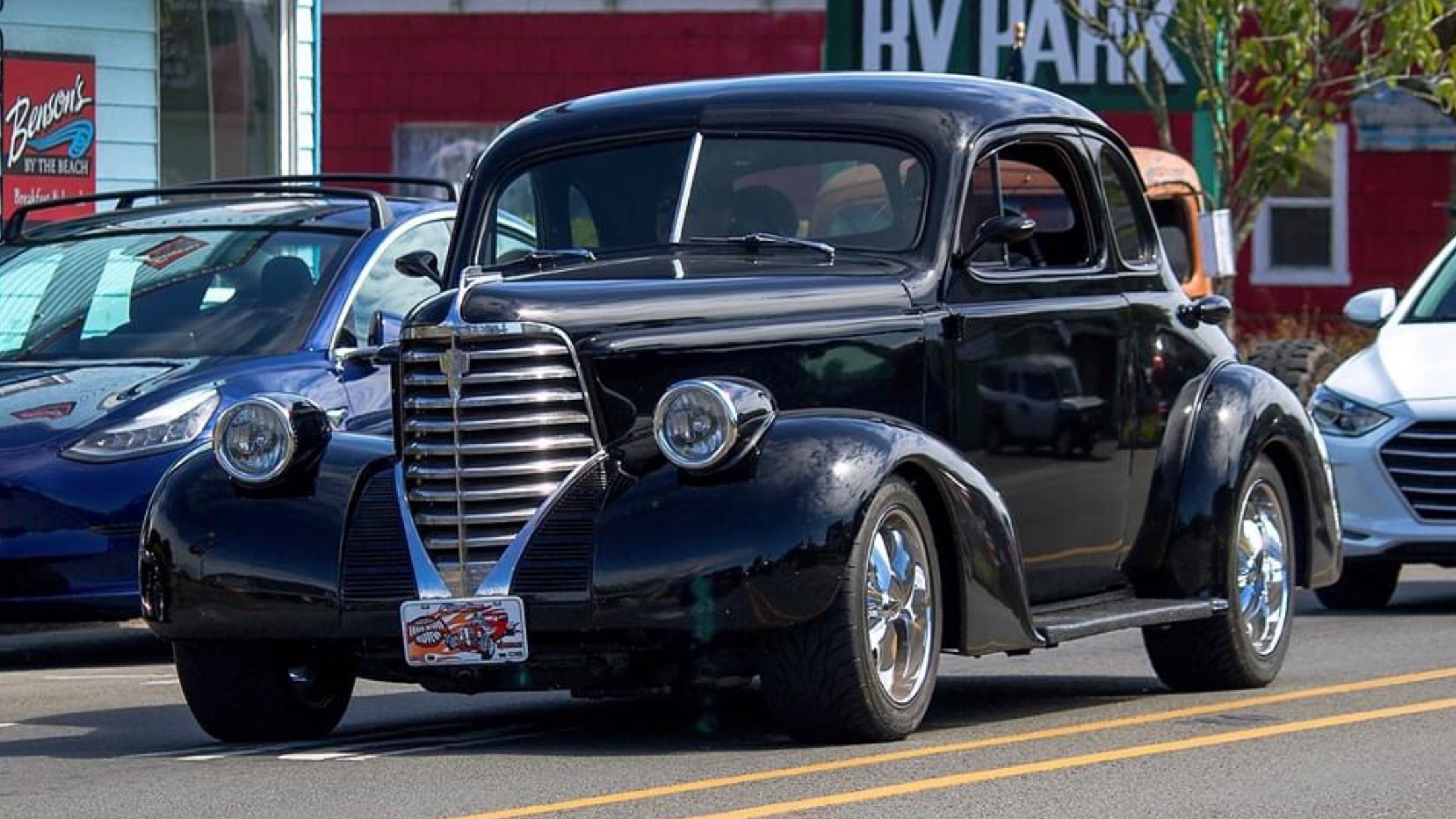

here is a pic last year at the end of the world rod run
