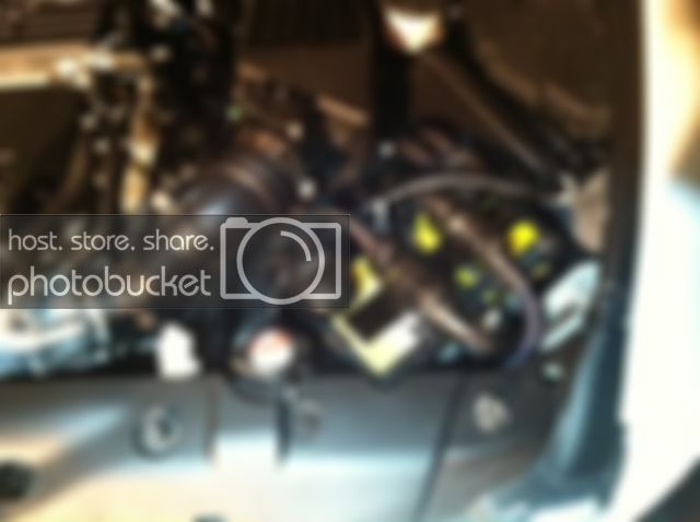

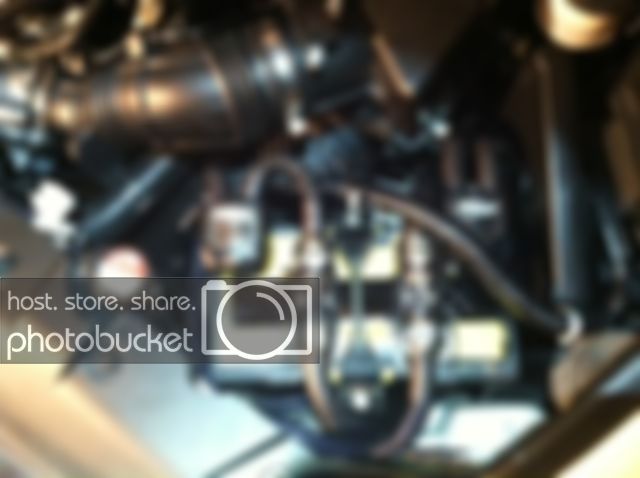

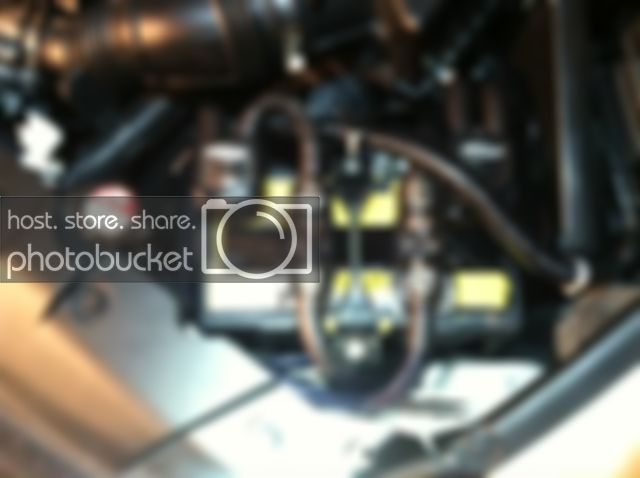

Finished big 3 a little while ago, upgraded to an optima yellow top under the hood. I will spare all of the details and just show the final result for the big 3. In a nut shell... All stinger HPM 0 gauge wrapped in tech flex, fused with mini ANL fuses due to space limitations. I used a piece of flat bar to mount the fuse blocks, I have a billet battery tie down on the way to dress it up a bit. I hate the route of the stock wiring, no slack to change it. Honda must have saved a few cents on routing the wire this way.
Let me know what you think.
Sorry about the bad photos, lighting was tough.
Problem is... Everything I have seen on disabling eld has been in older vehicles, I know my ECM is smarter then some of the vehicles I have read about but I have no idea how the eld will effect this particular vehicle. I would like the ability to enable the eld when not drawing lots of current because the alternator can present a large load to the engine and effect gas milage.
Yeah that is true you have a point as your car is a 2011....I don't know anyone with this particular issue as most ppl having been installing in older Honda vehicles....Guess doing the relay setup would be the way to go for now.....
