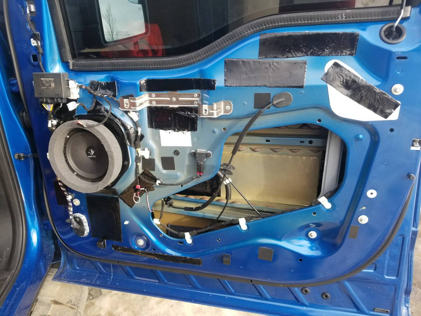

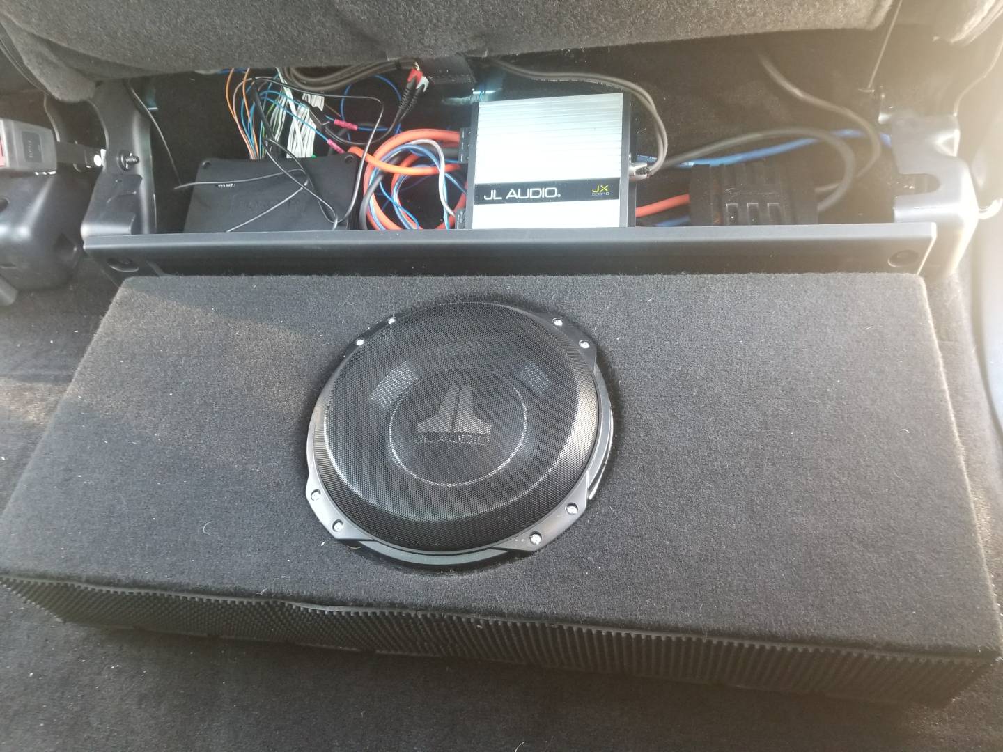

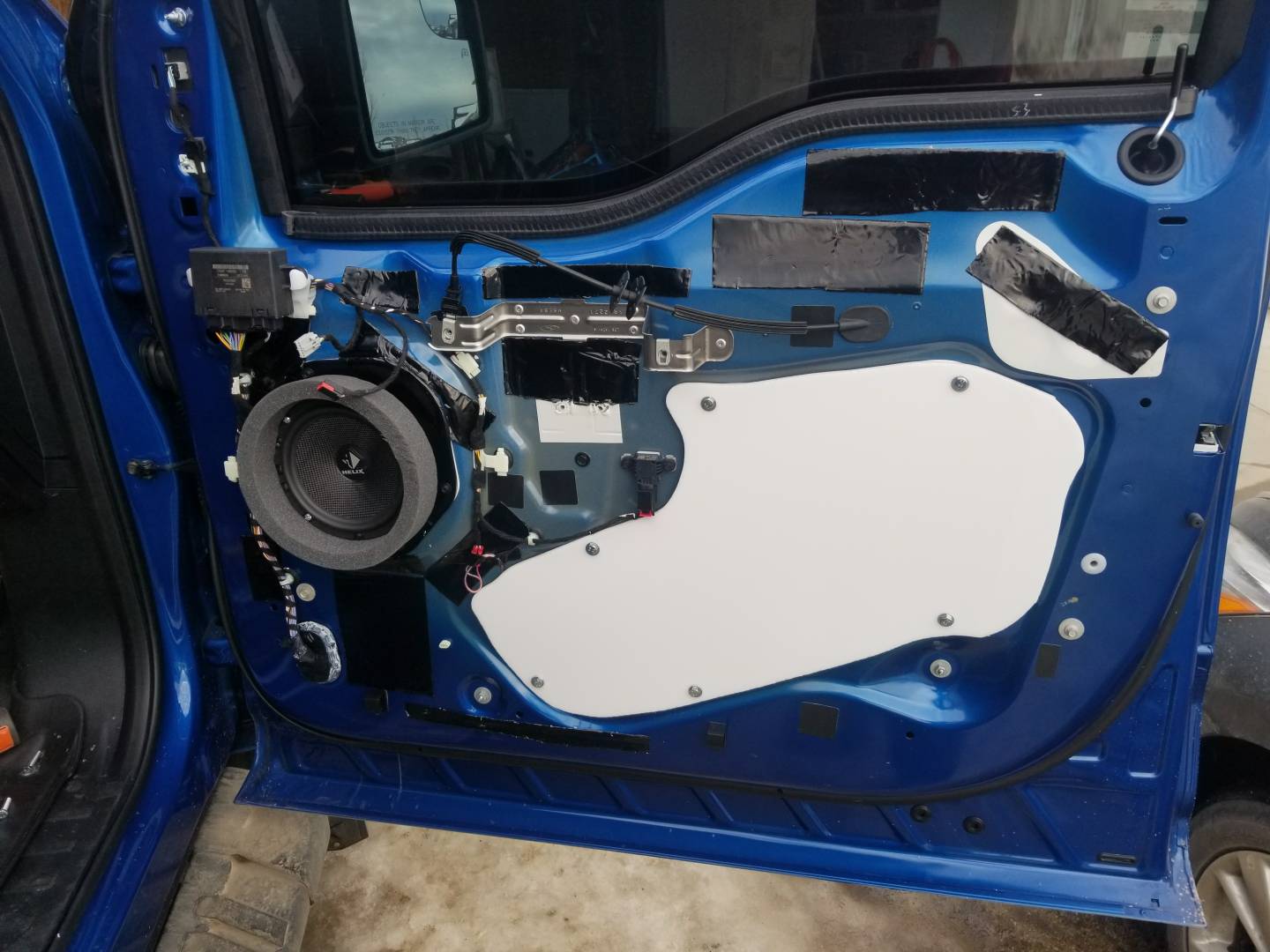

After a ton of research and listening to sound boards, and bugging the hell out of the local stereo shops, I ended up installing Helix E series 6.5" comps up front and then the matching 6.5" coaxials in the rear doors. I also installed hushmat on and in each door...and am looking at finding some 1/4" abs plastic to block off the large access holes in each door. Running off just stock deck power these speakers sound amazing compared to the stock speakers...almost good enough that I am considering not amplifying them (but seriously when my tax return comes in, I will be grabbing an Audison AP8.9 //content.invisioncic.com/y282845/emoticons/smile.gif.1ebc41e1811405b213edfc4622c41e27.gif ).
Purchased a Knukoncepts 4amp Kolosus amp kit to run the JL JX500/1D and the 10" JL 10tw3.
It sounds good...really good...but my inside voice keeps telling me it could be better.

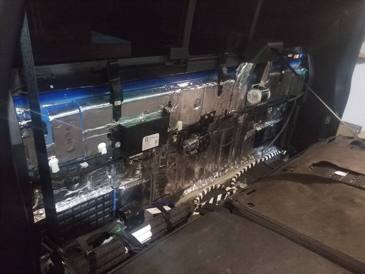

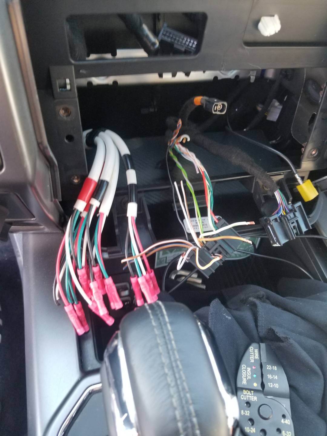

Next step is to purchase a bit more hushmat for the rear wall of the truck, plastic sheet to cover the large door openings, 3 runs of speedwire (8 inputs, 12 outputs as I will be running the fronts full active), and, of course, the Audison 8.9.

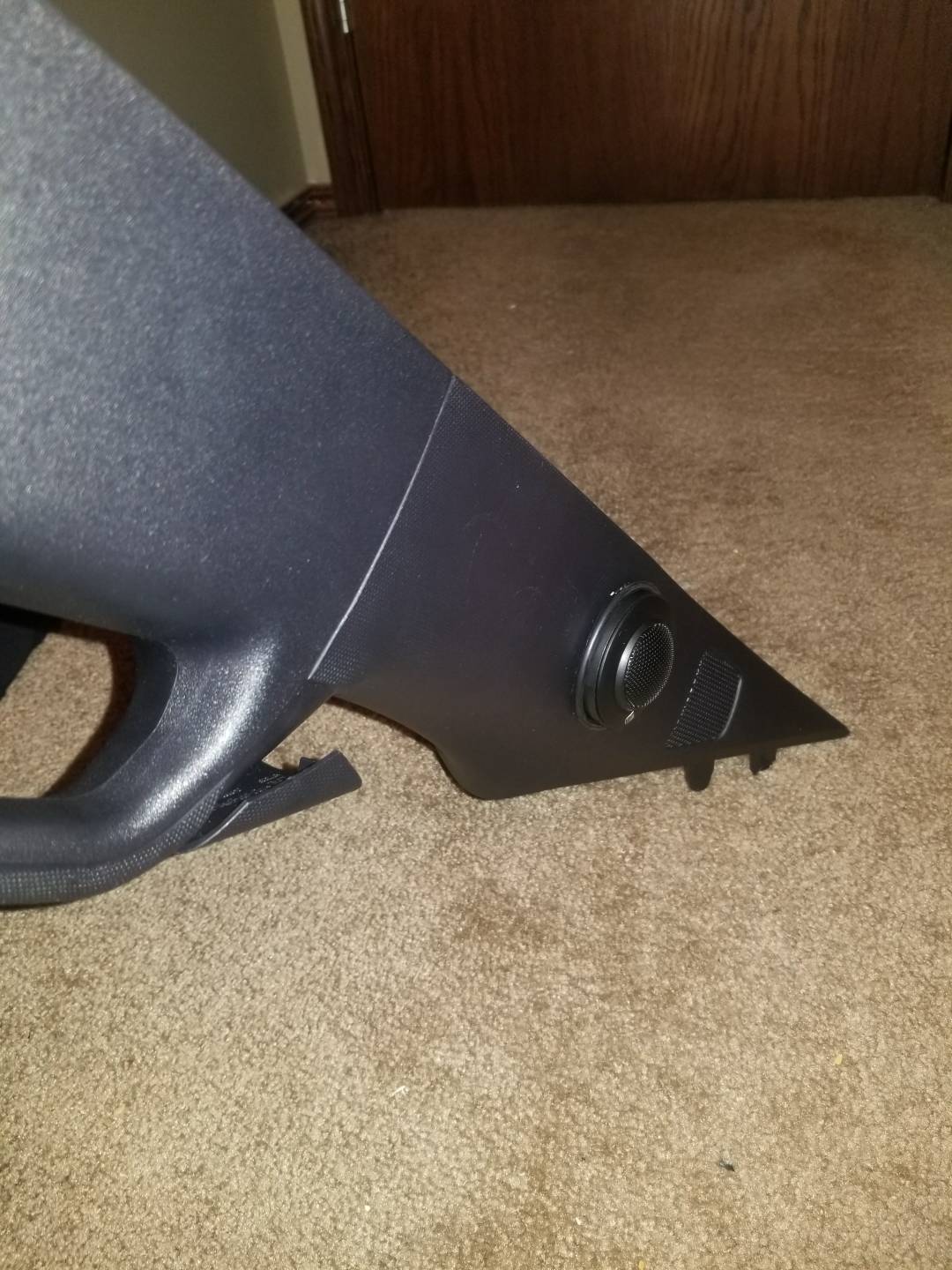

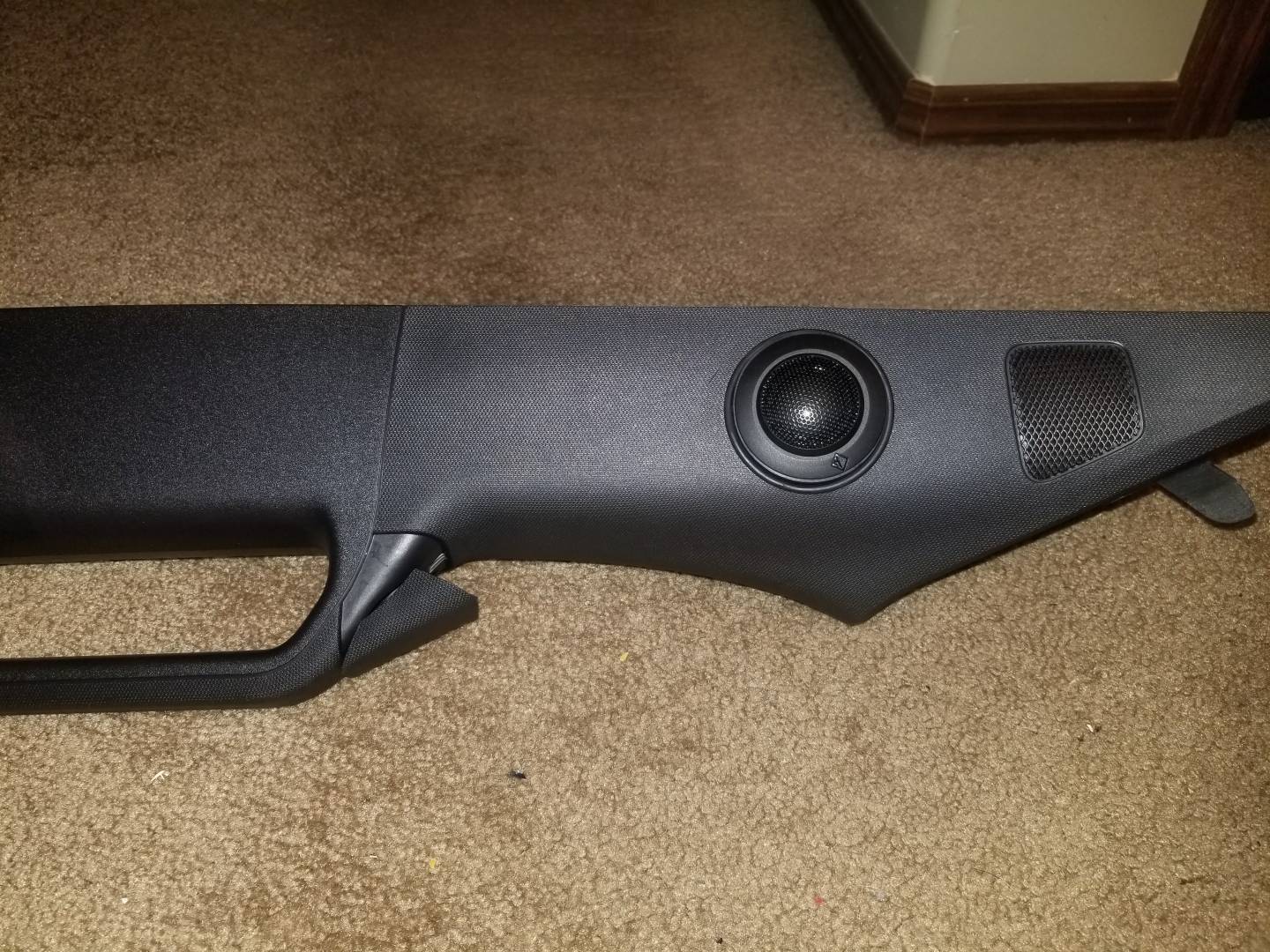

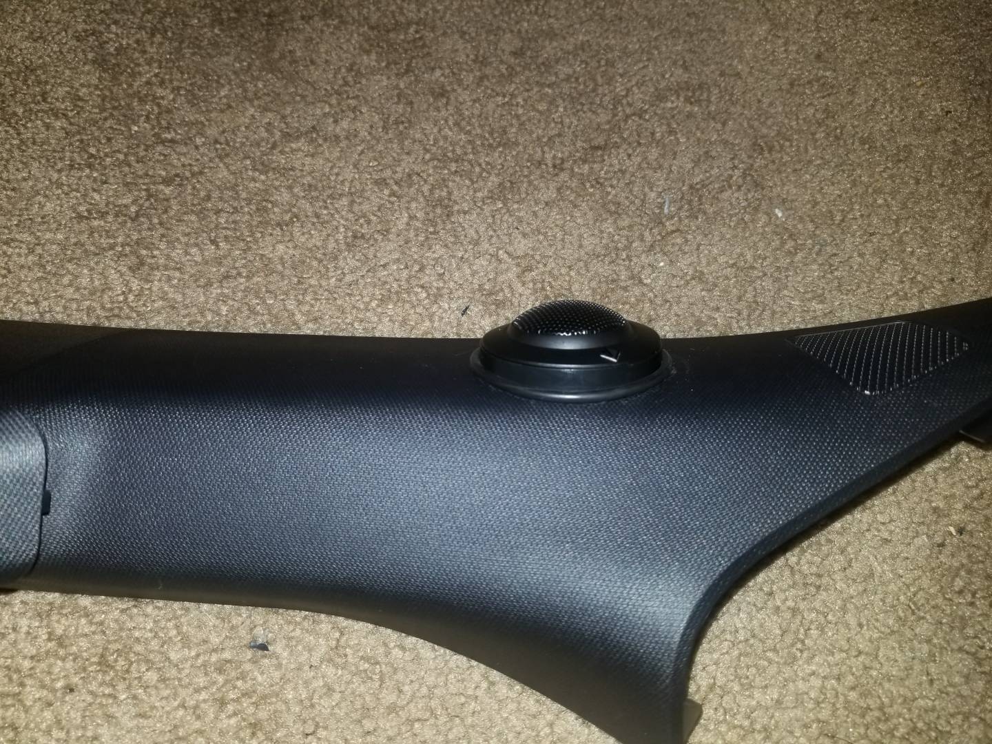

A pillars in the works... Turned out as good as I could have expected!

Anyway, a lot of guys have used plexiglass to cover holes in door panels. I've generally been happy enough to use just deadener. Before you go for a big rebuild try fading all the sound out of the rear coaxials and see how that goes. If you do the front right they should be completely unnecessary.

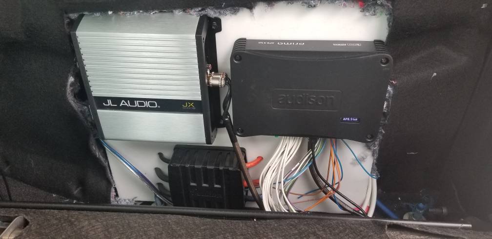

Been busy the last couple weekends. //content.invisioncic.com/y282845/emoticons/smile.gif.1ebc41e1811405b213edfc4622c41e27.gif
