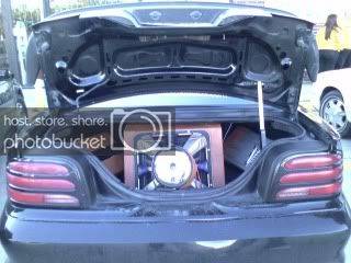

here is one of my setups i had in my 94 mustang! had to build the box inside the car. and take it apart once i moved on to another set up. 15in l7, kicker 1200.1, rockford 4004. all covered in ostrich! i was young dont flame me for it!
