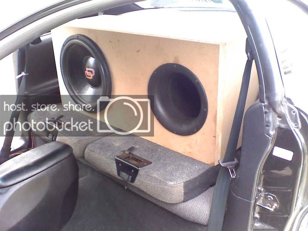

did the same with my 94. new mustang rear seats are inpractical im 58 and my head hits the ceiling when i sitting at a slouch take the rear seats out and fibergall a pretty ported enclosure with a pair of 15" subs check out allfordmustangs too theres some helpful people on there just dont swear they might ban u...
1st setup
2nd
3rd with a pioneer tsw8102spl.
sorry for the hijack but figured i'de show u some pictures. none of mine were finished but you could deffinalty do a nice job. you might just want to look into a rear seat delete kit and the find a box that fits ontop of that.
