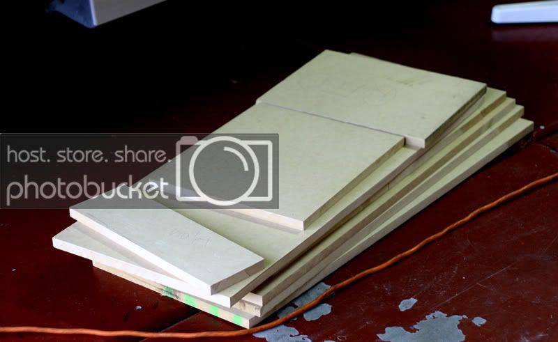

My wonderful cuts using a jigsaw

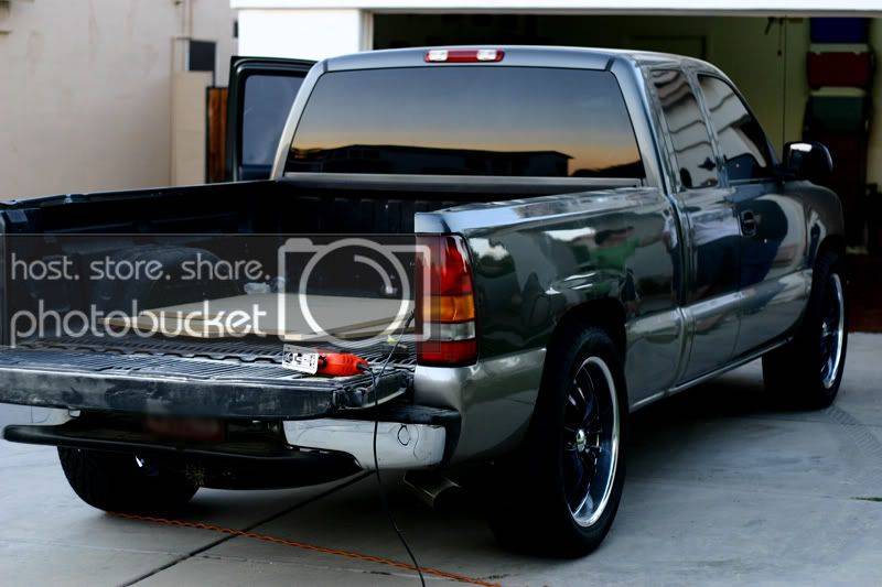

My work bench:
Tomorrow I cut holes for subs, glue and screw, then let her rip. then i will pretty it up if it sounds good.
