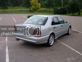

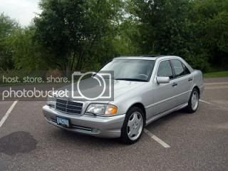

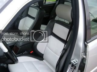

Here is the car-

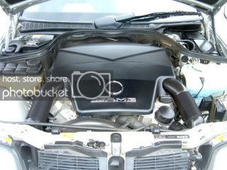

that is all bone stock etc.- my plans are to leave it very close to stock in apprearance and modularity, but to modify it to fit my style/needs a little better. This means i want to acheive sql levels befitting the fact that i derive quite a bit of my income from custom installations and car audio sales. I also want to modify the stance/wheels a bit- but don't/can't justify modifying the body or interior substantially of my vehicle. I have to keep in mind there are only about 1100 of these in north america, and it deserves to retain it's basic feel/soul/whatever. I WILL, however, be truly modifying the motor as soon as i finish my show truck and can put the funds away- it just sounds like too much fun to add another hundred hp or more with a blower from hps.com (i've talked to the owner there quite a bit, and decided i will eventually go with his kit).
anyways- plans for the exterior simply include lowering springs and these staggered (19x8.5/19x9.5) wheels-

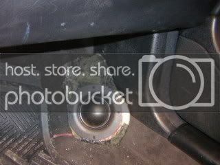

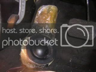

Here are a couple shots of the kickpanels with the Vifas-
I just plan on rapping them in matching vinyl- wanted to keep them as small as possible etc.
