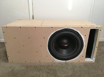

I got a new piece of 4" pvc so will use that for the port to keep things simple. Heat gun to flare the ends.
2.10cf @ 33hz
Little rough around the sub on the second baffle so used some caulk to clean it up. More work around the port, some paint and fill screw holes. Be a few days before I fire it up. Last time I make a box using a circular saw and jigsaw too much of a pain. Weighs almost 60lbs by itself. Sub is 25lbs. Used MDF I had on hand.
Sub sounds great. Box is perfect for rap. Metal sounds good also but wouldn't mind a little more kick drum boom. I'm going to experiment same airspace with a higher tune with a Aero. Or should I increase airspace and tuning? Is one 4" aero enough for this sub?
Just experimenting. Never tuned this low and used a slot port. Now I have an idea of what it’s about. Now I need to know what the rule of thumb is as far as how many round ports and what diameter is needed for a certain airspace and power.  I know some people say you don’t need as much port area vs a slot and some say you do.
