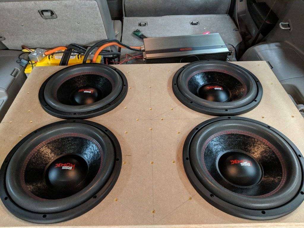

I have been wanting a sub that would work in a small sealed enclosure. The Demon fit what I was wanting, so I bought 4 of them and built a 4 cube sealed box. These subs are powered by a SSA IC2200.1 which is a great sub amp. Upon testing the subs through the low end range I was happy, so I placed the box in my 4runner and started running them at what I thought was a hard pace of music. Needless to say from rock to bass music these Demons hit hard, kinda of like a freight train and dig deep on the lows like my SSA Evil did. When playing lows 30hz and below it moves air like a ported box. Kick ass sub for the price when you realize it's capabilities! It reminds me of the demo vehicles from the 80's and 90's when I was learning car audio.
