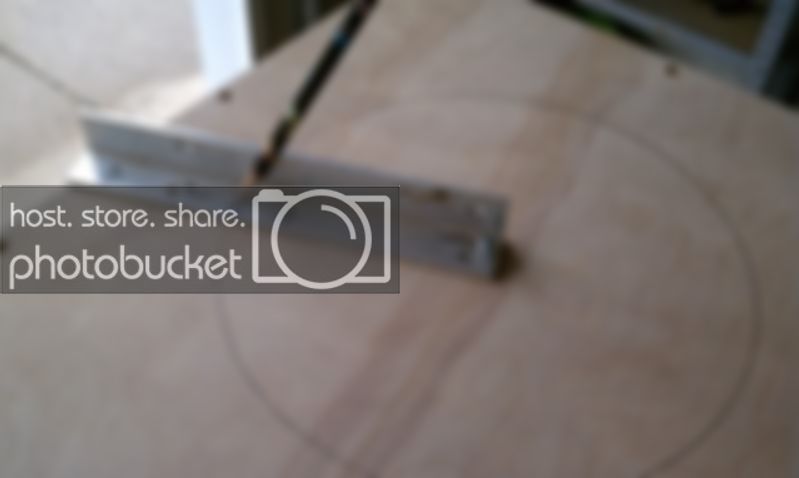

Spooney's Perfect Circle Jig:

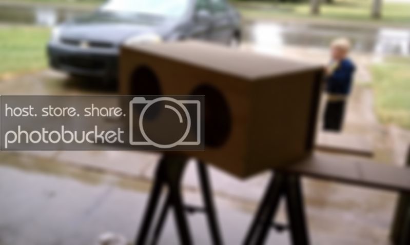

Holes Cut:

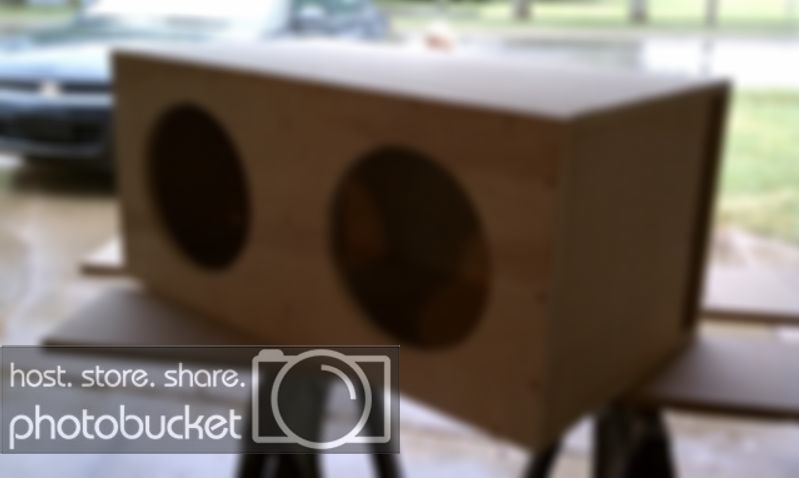

They aren't the roundest holes I've ever cut but the subs fit very snugly. Actually ended up cutting them twice because the cutout info I had was wrong so on the second pass around to open them up a bit they became a little rough. At this point its ready to drop the subs in so I can get a good listen while I decide how exactly I wanna finish this or if it even sounds how I want. Subs should be here tomorrow hopefully

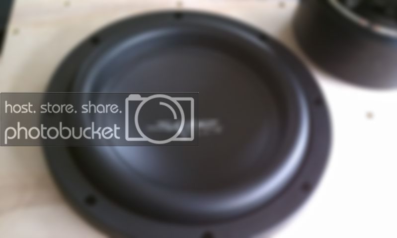

Subs are here and installed!!! :

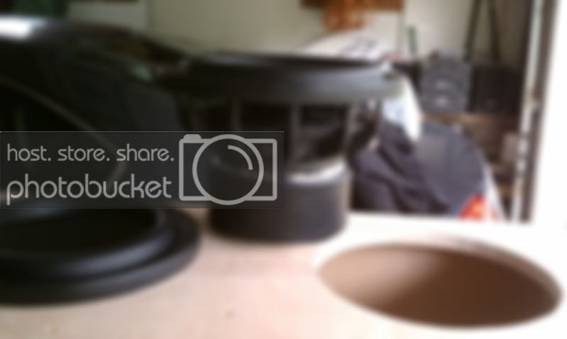

One sub isn't tilted quite as much as the other sub so they don't really match. Going to fix that once I actually finish this off:

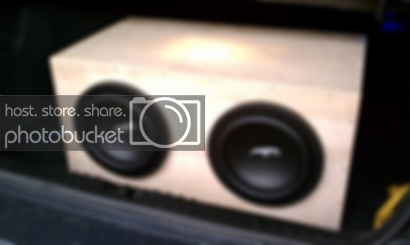

So far I am very satisfied with these subs. They seem to play everything I've thrown at them very well. Whether it be the low lows or higher bass they seem to produce all the notes well IMO. Smooth sound to them. Going to continue to beat on them for a few days and let them loosen up a bit and see if they start to sound any different at all but as of right now I am pretty much liking everything about this setup which is a real rarity for me. Gotta start thinking about how to finish this bad boy off now.
Turned out really nice! Personally, I love the look of stained birch. Also, I think they have "color" stain which can look nice too. I have yet to see anyone disappointed with the Skar subs. Pretty nice daily subs imo.
Thanks a lot man. Always been a bit afraid to post up some of my box builds . Got a lot of sanding and filling to do yet but I am definitely leaning towards a stain of some sort. Not really sure what all is really out there . Going to have to take a trip to home depot/menards to take a look
