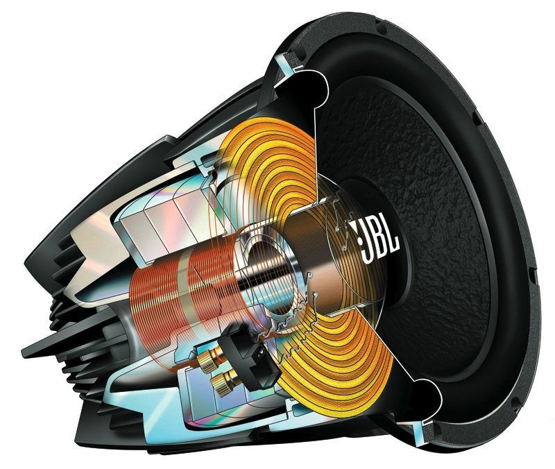

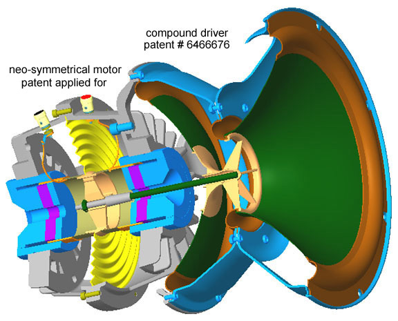

I see. I didn't realize the motor was set up that way in the JBL. In a sense, it has two top plates but they're locate at either end of the motor, using the same slugs and that's what provides the revers magnetic field for one of them. I'd never considered the braking force that would occur in that configuration. Most interesting. What I thought it would look like inside the JBL is pictured first, which as actually a CoDrive product. The JBL is pictured below it.
I'm right with you on my misapplication of the term 'linear', thank you for pointing that out. I was indeed referring to any potential asymmetry of the BL curve if you were to reference a graph plotting BL product versus excursion. Linear would better describe a system like the LMS coil working within it's mechanical limits. As I said, sometimes I'm not very good at articulating things. Thanks for taking the time to chime in.
