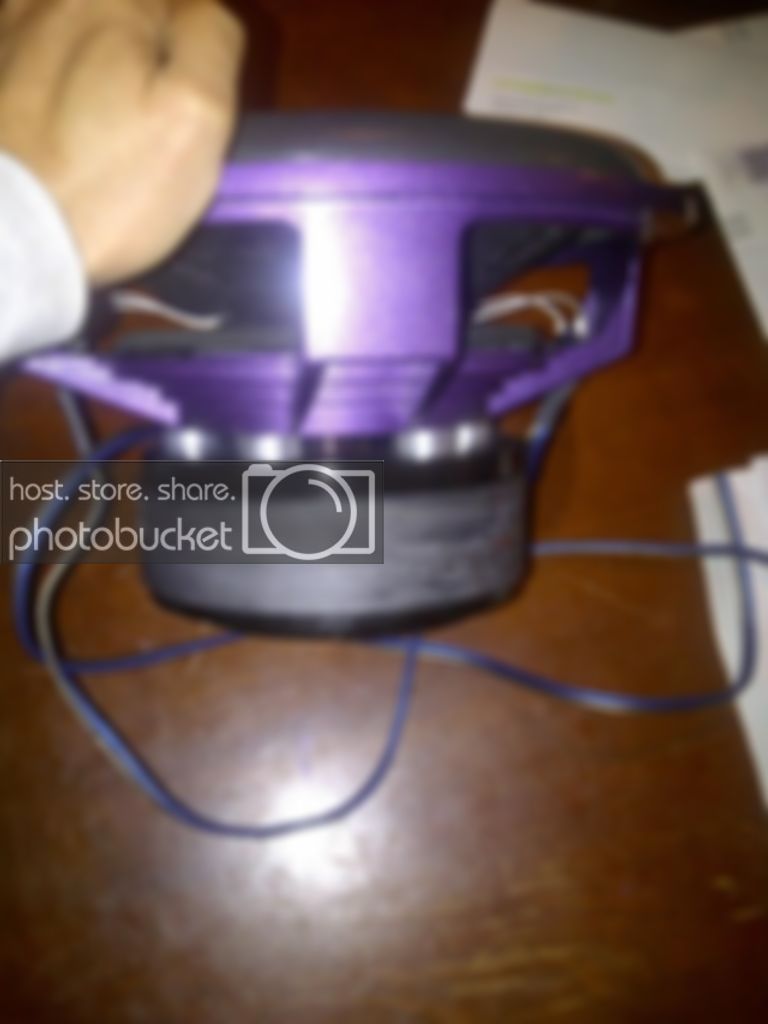

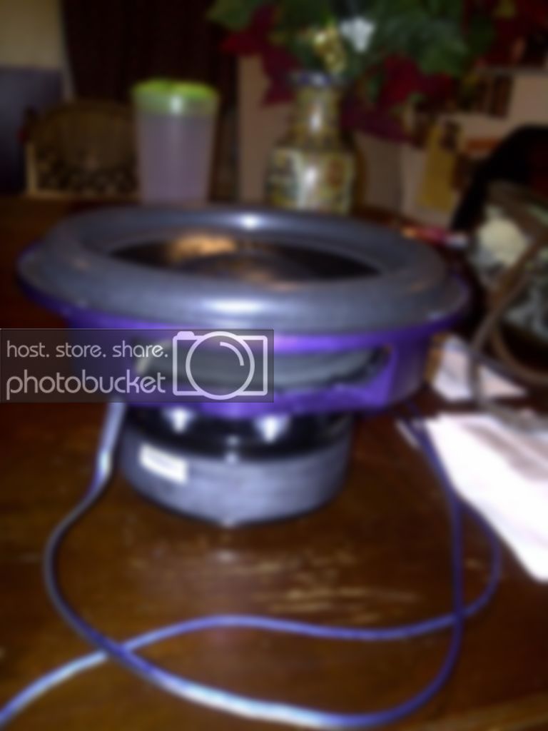

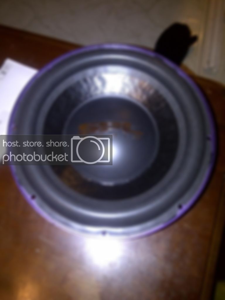

here is my beauty that Corey built for me.....thanks again bud.
sent him a db drive plw motor and this is my new 12" sub he made me.

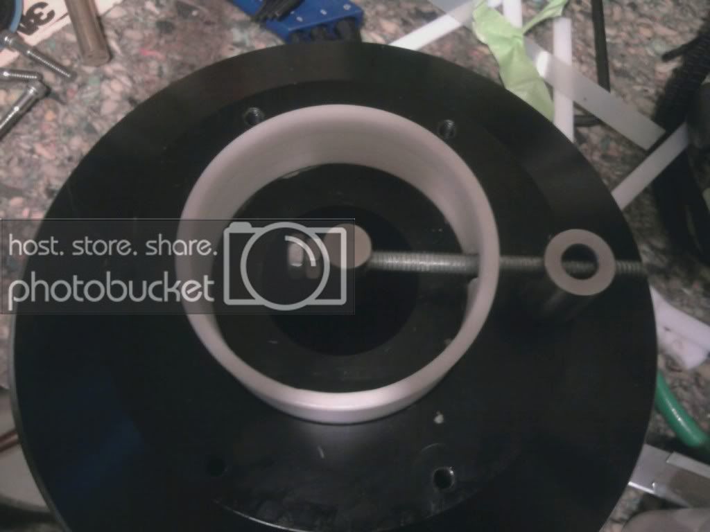

depending the motor that is how i realign motors. there is also other tools i have made to seperate the plates from the slugs to clean old glue out and put in new glue in.
those pbx subs are total custom being i removed the top plates and bored and then realigned. i build subs from without pulling ts or any of that as i dont make quanity i build from experience and personal knowledge of the parts i am using. i knew you would be happy with those 15s, turned them into sql monsters!
coil and spiders glued the rest is mocked up. working on it on the side between other subs...

9.375" spiders on 12" 12 spoke, 4" coil...
